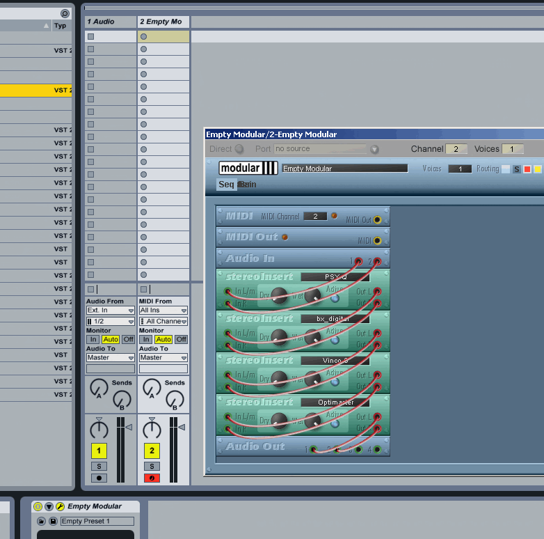

here we go ;-) just the 'normal' xtc tweeking:
modular xtc.gif (92.45 KiB) Viewed 4874 times
ahh... some grfx bugs? doesn't matter... modules can be dragged from expoler ;-)

I am dumb (as usual) so i don't understand what is that picture trying to say? I can do all that with "MultiFX S" or i am not getting whole picture of this?!?!?? Please could you explain better. Thanks for your efforts :D

I just made my 'standart' modular patch (yes, only fx, no synthpatch) an synth VST.
It doesn't matter what kind of patch you use. Simply take one of SCs standart dlls (there are mono fx, stereo fx and synth) rename it exactly like the patch you want to use (in my case 'empty modular')
and if needed, edit your vst-config.
1. Save your modular synth patch into the same directory as the 'normal' synths are. This way you don't have to edit the vst-config...
2. Take the VSTSynth.dll (app/bin) and rename it exactly like the mod patch. just leave .dll instead of .dev
3. Put that .dll into your vst-xtc-plugin folder
4. rescan vsts and ready...
