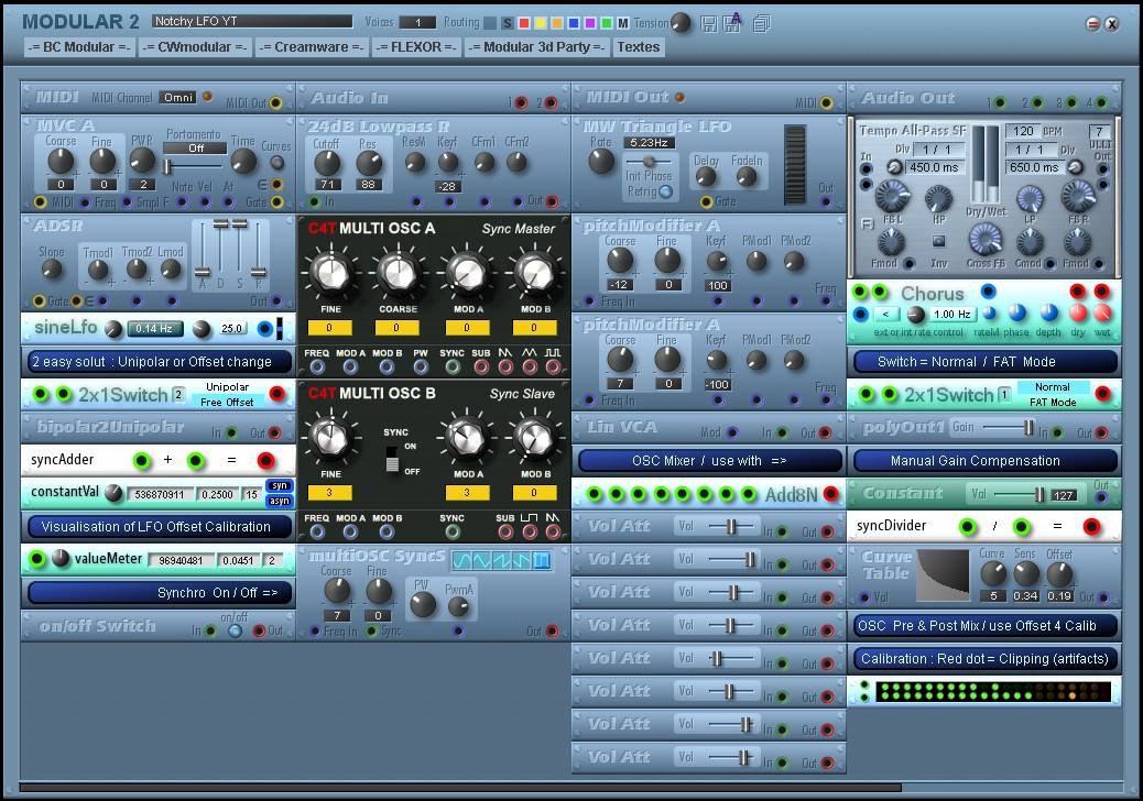

I'll post a patch with 2 very basics solutions 4 the LFO.
For artifacts, it is normal because there is no real standard mix in modular, all are incomplete.....
you don't need a limiter because with this you just reduce the amplitude of your signal but not artifacts, you must prevent artifacts but when they are here .......they are here ........
I've added one of my tricks to get a big Fat sound even with only 1 oscillator and without clipping
I don't understand why you say that you can not add other oscillators???
(as you know my english is a little bit ....
- Notchy LFO YT.jpg (254.6 KiB) Viewed 6663 times
If that do not the job like you want, i have other solution in mind (it's just a first tiny test...)
See you soon
YT

				Re: Notchy LFO's
				Posted: Tue Apr 06, 2010 7:14 am
				Yes this is a nice patch.
I was using advice from at0m with a bi2uni module and the module w/ a switch is a nice elegant way to do this. Unipolar to free Offset is nice.
So many neat tricks here I must spend the day dissecting.
I am also trying a MIDI Splitter so I can have the keyboard actually sweeping the filter with note values.
So many ways to go with this.
Thanks Boss.................

I hope the patch resolve your problem, I changed the MVC and the Filter because I don't have Mod IV (in fact i don't have SFP 5).
I'm just inspired by the picture of the post but if you look very carefully your pic, you'll realize yourself very quickly that missing 2 or 3 things .....
WIRING !!!!!!!!
I don't have mod IV, i can't open your patch ......... and with no wiring is a little hard
I just wired a patch logically with the modules that your image offered me .............. done in 20 minutes, 2 or 3 chords on the piano and posted on Z
If you have questions PM me
YT
