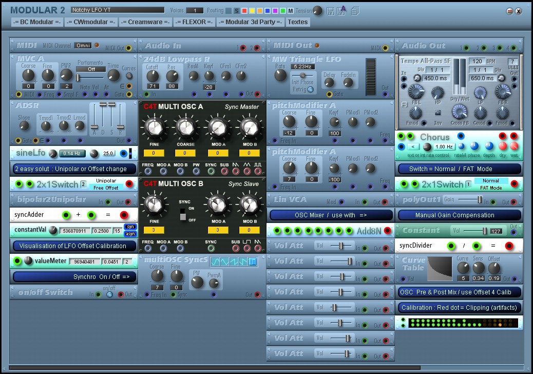

Re: Notchy LFO's
Hi Brother Jimmy
I'll post a patch with 2 very basics solutions 4 the LFO.
For artifacts, it is normal because there is no real standard mix in modular, all are incomplete.....
you don't need a limiter because with this you just reduce the amplitude of your signal but not artifacts, you must prevent artifacts but when they are here .......they are here ........
I've added one of my tricks to get a big Fat sound even with only 1 oscillator and without clipping
I don't understand why you say that you can not add other oscillators???
(as you know my english is a little bit .... )
If that do not the job like you want, i have other solution in mind (it's just a first tiny test...)

						Re: Notchy LFO's
Alright Brotha' Man.......
I have downloaded and will check it out now....
Thanks Buddy.....
Thanks Buddy.....
Re: Notchy LFO's
Yes this is a nice patch.
I was using advice from at0m with a bi2uni module and the module w/ a switch is a nice elegant way to do this. Unipolar to free Offset is nice.

Re: Notchy LFO's
Thank you Jimmy
I hope the patch resolve your problem, I changed the MVC and the Filter because I don't have Mod IV (in fact i don't have SFP 5).
I'm just inspired by the picture of the post but if you look very carefully your pic, you'll realize yourself very quickly that missing 2 or 3 things .....
WIRING !!!!!!!!
I don't have mod IV, i can't open your patch ......... and with no wiring is a little hard
I just wired a patch logically with the modules that your image offered me .............. done in 20 minutes, 2 or 3 chords on the piano and posted on Z
