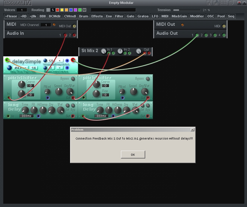

I'm trying to make some delays with pitch shifter or filter in the feedback loop. But every time I try to reinject the sound signal in the feedback loop, I get an error message... It must be possible to do so but I need some advices...
On the jpg, I was trying to wire simpledelay output to the mixer. Which module should I use ? --- Thanks ! ---

Not at my Scope PC at the moment, but I think there's a modifier module called 'Xmod & Feedback Connector' which you need to insert before the signal which is being fed back in. This will allow you to set up a feedback loop without that error message. Hope that helps,
Ben

Yes ! Thanks a lot ! I gonna try this ASAP ! I'm not at my pc either... I was sure it's possible...

Thanks a lot !! Exactly what I was looking for !
