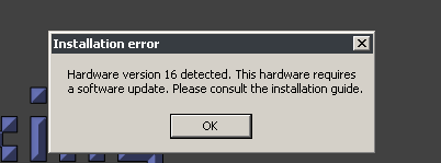

I've change a cable for the microphone, and BAM! creamware gave me some weird Protection messages and since then the program stopped working...
I tried to restart windows and it give me message "installation error - "Hardware version 16 detected".... (it also said hardware ver 30 detected before..)
what to do ?
anyone else suffered from this ?

I've fixed it by unpluggin and repluggin the sound card from the motherboard, and when I entered that mic cable I got the annoying protection error again..
shame on you creamware...this protection shit suckz

Soulds like static discharge.Btw.Creamware is dead for years.Everything grounded properly?
