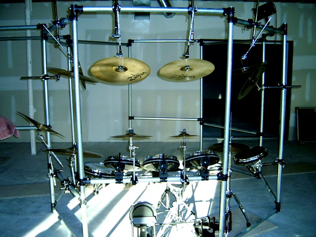

This is my new drum rig, I use a TD-20 with a TDW-20 expanded module...best sounds I have ever had...I even had DDRUM 4... :wink:

The TD-20 was quite an investment...but worth EVERY penny.
I can select the wood, the depth, tuning, effects, the drum head, the muffling, the positions of the mics, including on the floor, overhead, or even the next room!
I know...a pretty sick drum rig...those cymbals are 1982-1983 stamped Zildjians...the REAL thing, before they started screwing around with the alloys...A, Z, K...etc etc... :wink:

MY GOD that rig's insane! :o
I'm guessing it's gonna be improved bit by bit huh?
And what are those pads? those aren't Roland's...
u say the TD20 sounds better than the DDRUM4? interesting...
I was thinking about upgrading to a TD12 but now with these VST's working I think I'll keep my TD8 for a while :)

DDrum II. A real rim & drum head..10" toms and the floor tom...ha ha is a 12" and so are the (2) snares.
Phase II will be a stand up rig to the left of the photo w/ a Roland SPDS (2) Nimrods (2) Dingbats and (2) Hart Hammers & (6) more DDrum II pads, all commected to a Roland PM16. Behind the kit will be another sit down kit with 10 Simmons pads, and a variety of FX cymbals...trash, pangs, chinas...etc etc connected to another Roland PM16. The PM16s will be connected via MIDI to my XITE-1 loaded with STS2000 samplers, filled with a pretty huge library I've accumulated over the past 15 years... :wink:
I have all the pads, triggers and the PM16s, now I just need all the mounting hardware...the SPDS is under the towel... :lol: :wink: I have issues... :lol:
Stay tuned....later this year, when it is done, I will announce the completion and openning of my new post production/redcording/jamming facility. Plenty of pics will follow.... :wink:
