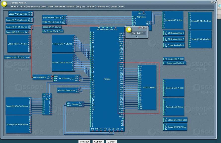

I am routing the mixer master to wav source and monitoring through analog source (also connected to mixer master.) The audio sounds fine coming out of my monitors but is distorted in the recording (levels are good and not overloading in the recording application.)
I use outboard synths and effects in this project and need to mix down in real time. I thought it might be a disk performance problem but 44.1 16bit is also distorted. I've also tested "wav source" recording in more than one application and get the same result.
This is the way I typically mix down and haven't seen the issue before. (Scope 4.5, 2 Luna 2 cards, 1 Pulsar, Scope is master)

bosone wrote:why you are not using ASIO modules?
ASIO was used by my DAW. Since only 1 ASIO application can be opened at a time I have been using the wav source in a second application to record mixes.
But it seems I can route the creamware mixer outs back into another ASIO stereo pair, record it in the DAW application, and export that stereo track.

sodiumcycle wrote:But it seems I can route the creamware mixer outs back into another ASIO stereo pair, record it in the DAW application, and export that stereo track.
That's what most of us are doing, I suppose... You can also separately route every track you mix in Scope to the Asio through mixer direct outputs and record in separate audio tracks to be mixed afterwards, if needed.
