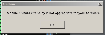

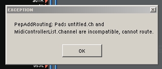

After assgning the 1st dsp to the 32 channel mixer, here is what I get (on .jpg)... And with the 6st, it's the same... I don't have anymore the optimization message but those ones, now. And there is no sound coming out of the mixer, no vu activity nowhere...
				- 32cha-mixer2.jpg (19.7 KiB) Viewed 13146 times

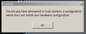

And then this one after switching off a channel in the mixer !
There is also this strange thing : I saved my project with a lot of channel mixer switched off and each time I load it again ,the channels are on, even after saving the mixer as a .mdl and drag into the project.
Thanks for help if you have any idea !

When I assign the mixer to one of the firsts 6 dsp, I get the message wich says that the hardware is not compatible and with the other dsp, it's the optimization message every time I do anything on the mixer but al least, I have some sound.
