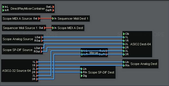

So, if I'm not very much mistaken, I have to create a new XTProject.pro with all the various in's & out's that I'll be using. That's the plan.
ns
the19thbear
Posts: 1499
Location: Denmark
Re: The Integration Of The VST
Post by the19thbear »
exactly :)
Happy xtc-ing!
- by the way: you can also use any mixer you need in xtc mode.
Just load it into your xtcproject and leave the mixer visible (open) when you save your project.
It will pop up when you open your daw.
(and you can use modular 3 as an instrument vst in xtc mode as well.. Do a search for "renaming trick" in the xtc forum)
