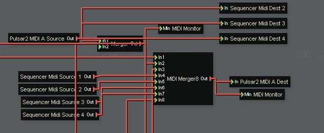

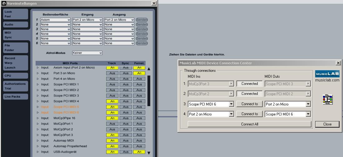

ok, akaik you can't use your scope/Xite HWMidiOutput directly. You have to create a Midi seq dest/source and connect them with your HWMidiOut/In
in the routing window... If you want to use a second program, create a second pair of Midi Dest/Source and connect them via mergers in the routing window... Got it?
Re: Multiclient MIDI drivers still no go ?
Posted: Fri Oct 30, 2009 4:42 am
by Janni
- midirouting.JPG (27.84 KiB) Viewed 5254 times
- mididriver.JPG (81.53 KiB) Viewed 5252 times

Janni wrote:ok, akaik you can't use your scope/Xite HWMidiOutput directly. You have to create a Midi seq dest/source and connect them with your HWMidiOut/In
Janni thanks for your input but i know for all this what you are saying. I am using it this way(similar) for years. I think you don't quite understand what i am talking about. Do you have some hardware like synth or sampler so you could test this for yourself? I'll try again(i know, my english is terrible). You simply cannot access (you can see it but..) to MIDI out port with two applications at the same time. All resources will go the the first one loaded(your host for example). This is not multiclient behavior. While for example i can do it without any problem on EDIROL UM-550 or Um-880 or Motu MIDI patchbay. I can access to the very same port with few applications at the same time.
Google for "MIDI Multiclient" option.
Posted: Fri Oct 30, 2009 6:57 am
by Janni
Sorry... I think my sequencer (ableton live) leaves unused midiports untouched so other applications
can use them (like I tried to show in my picture). May I ask what kind of seq you are using?
Maybe you can disable (in the seq) the midiports you want to use with your editor?
Maybe it helps to open first the editor (then midiport is blocked by editor) and then open seq?
Again, sorry...
