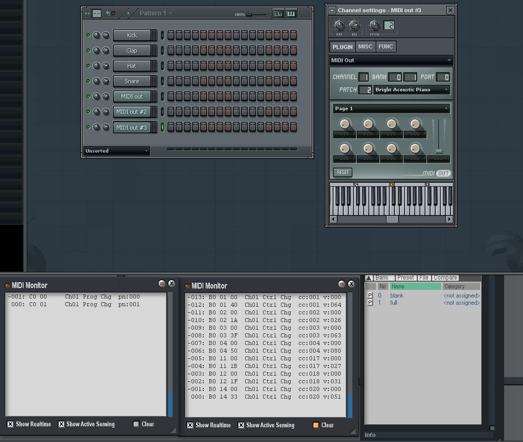

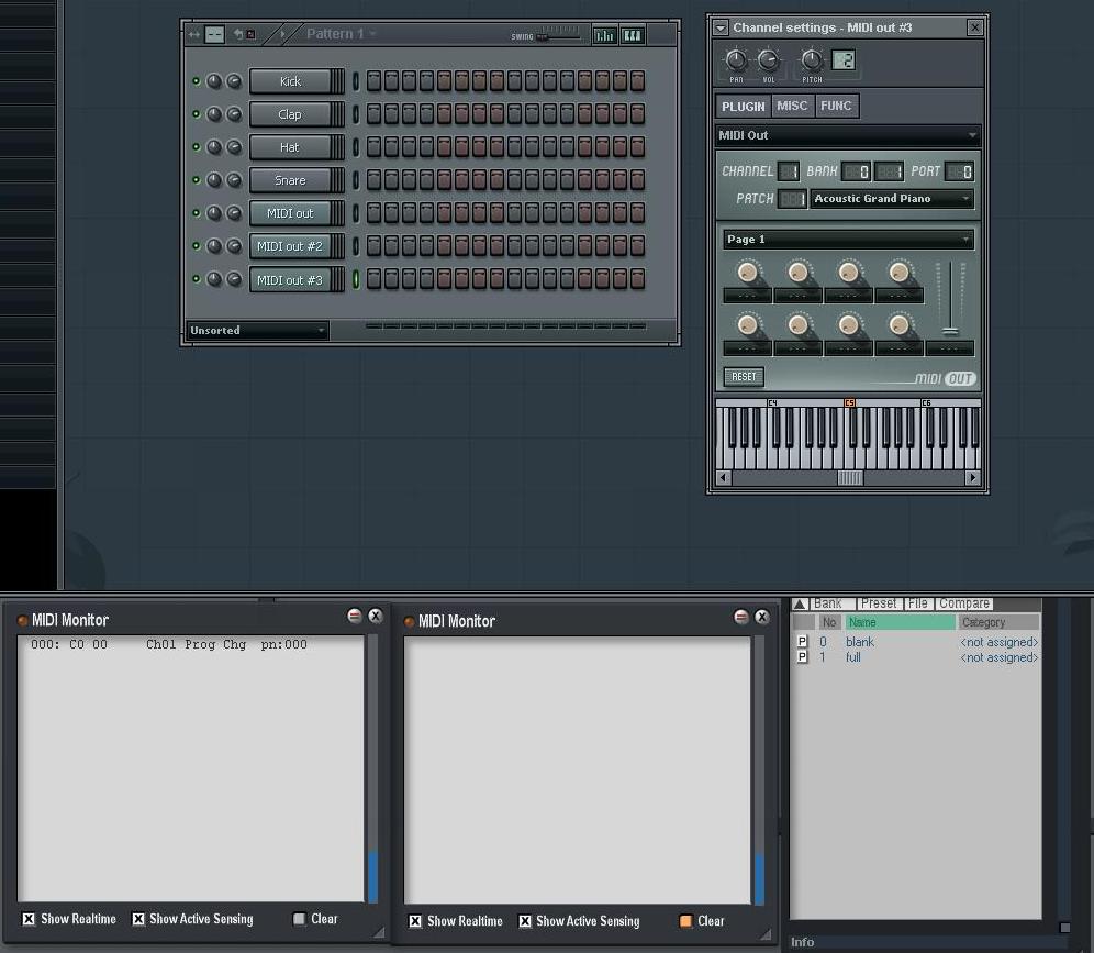

here is some screenporn
nothing.
nothing.
patch 1. cause program change. blank midi preset is loaded
patch 2.  causes program change. full midi preset is loaded! All CC go out :D
