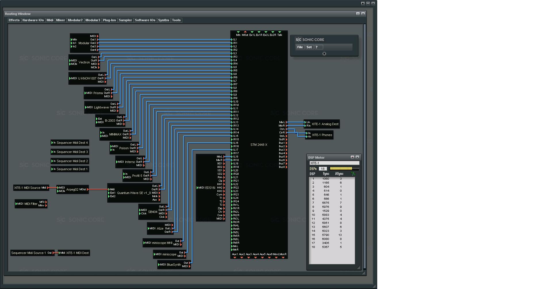

This demonstrates the ease of use XITE-1 is when the loads are thought out in advance.
I am using 3 x Synths that span across DSP's. And it's a large template with QWave, Prowave, 2 x XOR's, B2003, the SpaceF MultiSynth using 3 x MIDI Channels, 4 x Modulars and SpaceF's MiniHost.
I can load up tons of stuff as long as I know which synths are spanning DSP's, and make sure when I load the project those synths are set at their maximum voices prior to spanning.
QWave is 4 voices, and the same with Prowave, so once loaded I raise their polyphony to 6.
Then I go to SpaceF's MultiSynth and raise the polyphony on 2 of the synths to their needed levels which is 4 voices on 2 x parts and mono bass on the 3rd.
2 weeks ago I couldn't even use MultiSynth, thanks to SC & Ralf D., the SpaceF stuff is now starting to be added to my projects.
The Legacy MiniHost synth shell is packed w/ RDII, Flexor & SpaceF Satellites too.
I have everything I need as far as effects go in the Mixer, but I am going to start experimenting with effects and the mixer now just to see how far I can go.
It's sure a nice day in XITE-1 world.......... :D I still have 3 x unused DSP's and room for more stuff on 5 DSP's. Pretty serious loads for 50%.

Here's my mondo synth project so far. Most synths have 5 voices.

I decided to not give up with different combinarions of loads, and I have created some extreme results, that are repeatable.
I load up a mixer, w/o effects, then the B2003 or an XOR or any synth that uses 2300-3500 using it's default settings.
Then I add the mixers effects and keep it on a single chip.
Then load Prowave or QWave SE and it loads in on chip #16.
I then assign it to # 18 while it is low in poly.
Once it is on #18 I un-assign ( clear ) it and start adding polyphony.
It doesn't span DSP's but rather loads and loads and loads.
I have 7 voices on a single chip, and I am using Osciallator Pairs and Custom Filters too.
Take a look at these numbers and see if you can repeat this on your XITE-1 using synths w/ the same DSP needs. For Prowave I would use a large Modular Patch or Atze, but I can't get Atze to do more than 3 voices before it causes troubles, but it is a big hungry beast.
Anyway I can repeat this process over and over.
I just want to see if similar numbers can be reached on other XBox's.
