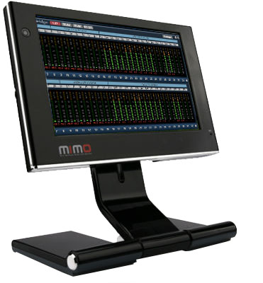

I was thinking of getting a (or two) Mimo 7" screen for the purpose of a dedicated meterbridge for Scope. Any advice or first hand experience is welcome.
See:
http://www.mimomonitors.com/
and
http://createdigitalmotion.com/2009/07/ ... erm-value/
Something like this :)
scope meterbridge.jpg (43.71 KiB) Viewed 2082 times

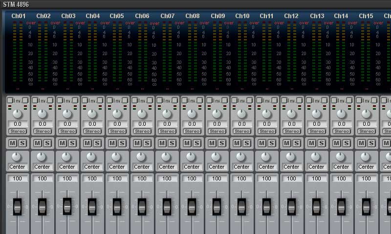

800 pixels is not enough for the stock meter bridges.
Posts: 7766
Re: mimo monitor as dedicated meterbridge for Scope
Indeed, was just making a screenshot and u beat me to posting. Still...for reference:
mimo monitor resolution

However I'm sure other uses can be found, and having the rapidly updating portions of Scope's UI on a usb based 'graphics card' + monitor makes me wonder what its load on the system will be (servicing the IRQ, handling the PIO for the serial mode usb which is all cpu bound, calculating the onscreen display, etc)

Two meterbridges would partially fit so that 2 x 26 channels of metering can be visible. I don't know if my 3 GHz P4 can handle more CPU load because it is reaching its limits.
