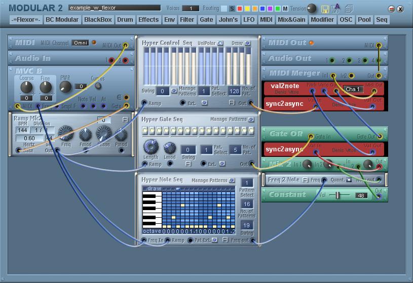

Ok, I've come with a basic Modular sequencer but now I stucked when trying to trigger the ramps from a simple midi note and have everything in sync.
Here is the patch:
Thanks in advance for your hints.

I wonder if that's the best place for the Gate OR? Try moving it to between the MVC B and the Ramp module and see what happens.
Cory
Re: How do you get some Flexor LFO signal to the Mod Midi out?
Posted: Wed Aug 26, 2009 1:17 pm
by cortone
...and send the Hyper Gate Out straight to the Val2Note...

Here is the next screen of my current mod patch:
This is what I found in the tutorial given by Wolf (the tut is called "example_w_flexor") and it looks like it is allowing me to connect to the Val2Note Gate signal. I tried to do without it there but I can't connect my gate seq to Val2Note Gate IN.
As I stated, I need it for linking Gate Seq and Val2Note Gate IN. If I add a new Gate OR between MVC and Ramp, it doesn't sound as it changed sthg.
Posted: Fri Aug 28, 2009 11:09 am
by cortone
The only other thing I can think of is replacing the Gate OR nearest the Val2Note with an async2sync...but that would mean that the second Gate OR was causing the problem, which doesn't really make sense.
Maybe Wolf will pop in?
Cory

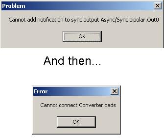

Posted: Fri Aug 28, 2009 11:17 am
by iSiStOy
... Tried that.
Got:

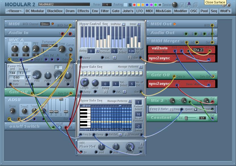

Posted: Fri Aug 28, 2009 2:28 pm
by roy thinnes
..just coming back from the ranch (honestly)
IMHO using Flexor modules together with Wolf's val2note module doesn't make much sense. Flexor's advantage is it's precision = being very time-accurate. this is achieved by using "sync" dsp modules. so if you transform it's output by using a sync/async module, it's advantage is gone.
- you already saw that the HyperNote module makes problems when fed into the Val_In input of the val2note module: it's freqOut scale is different from a Control module's output. use a ControlSeq module instead.
so if you want to trigger an external synth by Modular seqencer modules, just use the provided standard Scope Modular modules:
CtrlSeq -> val2note Val_In,
another CtrlSeq-> val2note Velo
gateSeq-> val2note Gate.
If you really want to use Flexor modules, just use HyperControls for the two val2note inputs. (in the pic you see I used a CtrlSeqPSw module, which also outputs sync signals; I used it because it's "Random" feature.)
btw another nice Wolf module is "val2control": if a CtrlSeq is hooked in, it spits out MidiCtrl values which can control whatever Synth parameter you want.
Posted: Fri Aug 28, 2009 10:23 pm
by iSiStOy
OK,
sync-async means something more, thanks to you!
Now I understand why Flexor accuracy shall be used for control & accuracy of signal and that to midi out with these modules is some sort of a waste (even for val2control I imagine, because of midi).
Otherwise, the Hypernote caused me some trouble with signal level as you said but it is so convenient for drawing patterns.
I must say I'm eager for any pitch edition tip with these stocks CtrlSeq. How can one be precise with a mouse in this case?
Thanks for the screenshot as well.
I plan to use the val2control sooner or later and was in the need of modules and basics on midi note/vel/gate output path, I now have with Wolf's toolbox and advices.
I definitively don't regret it, and I will also get me the sPEQtrum really "soon".
Anyway... In this module case, I'll use Flexor more for whatever external devices with control In through audio path then (or the pro_wave modular module) and in other cases, for freaky sound twists :D
Let's use it.
