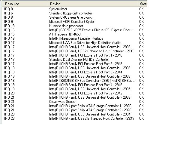

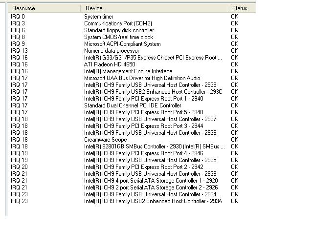

I attached pictures with IRQ list, with the scope card in 2 different slots. Only option left is IRQ 17, but the card doesnt fit in that slot , because of the sata cables ..
Im using 3 usb slots right now; for mouse, keyboard and Midisport 4x4. I could disable these usb ports and change them to another usb slot. I can also disable the PCI-E right now. But there is also a device called SMBus Controller. Can i put this one off also ? This way scope should have it's own IRQ.
I could find any IRQ list in the bios btw, using Pause/Break..

i'd swap slots.
the sata controller probably won't make any issue, but the usb controllers will. it's no big deal to disable a couple of controllers though....

I still have crashes leaving the Sata controllers on and the usb off, so that my scope card is only sharing IRQ 21 with Sata controllers...
The only option left would be swapping the card to my other pci slot. I could disable all usb controllers for IRQ 17, but what about the Dual Channel PCI IDE controller? Can it also be turned off?

You're right Jimmy, but untill xite arrives, i will have to do deal with my scope card first...
Do you have all SATA ports disables in the device manager ??
Can you upload a picture of you're irq list in the system info ?

Im sharing IRQ with 2x SATA controllers on IRQ 21 right now.
Re: Assigning IRQ's on Intel dp35dp
disabling usb won't mean a reinstall if the mouse/keyboard don't work. it means using a different usb port.
the sata controllers usually don't make problems, but as long as you connect the drives to other ports(you have like 6 sata ports), you can disable those, too!
