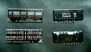

You could also buy these replacement chips.http://www.analoguerenaissance.com/D80017/

This doesn't help directly, but - I've had exactly the same problem with voice 5 (of six) on a Crumar/Unique Systems DBE/Bit01. The solution was to clean & reseat the socketed filter chip (CEM 3328 14 pin DIP).
I looked at Fluxpod's link & it looks like the filter IC is soldered directly in. Does the problem goe away when (gently) moving the chip for that voice?
If so, it might be fixable by a careful resoldering of the pins. Low-ish heat setting with a really small alligator clip to draw off the excess heat. That's what I'm thinking anyhow. It might be a bad internal connection too, so moving the chip works, but reflowing the solder doesn't.. :cry:

Shane you might consider collecting a few spares as long as they are relatively affordable.
Prices are constantly on the rise for CEM stuff (I assume it's CEM inside...)
A pro dealer here charges 99 Euro per chip :o :D

It actually is a custom Roland module, which does both the filter & VCA (from the article, it's the amp part that usually goes south):
