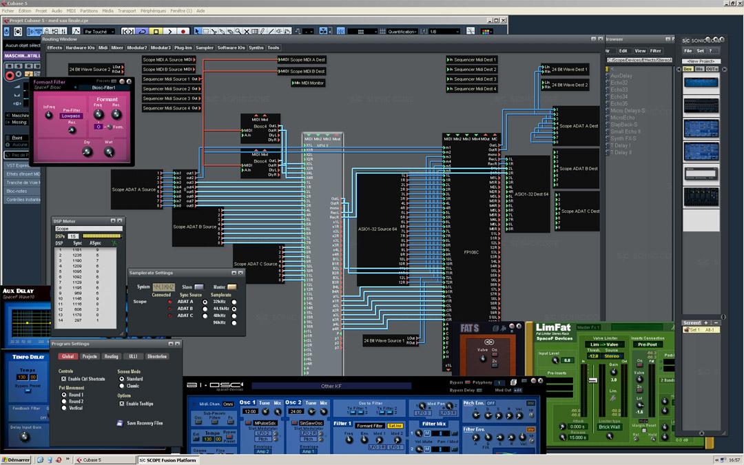

It all works very well without the need to change anything in your installation.
I have kept my scope 4.5 install for the moment, it is easier, and in fact, works fine.
If you have BlackBox II, follow those steps
- Load Biosc 4 rev 2 in the project
- Set the search options to search in the Mono and Stereo folders of you Scope 4.5 install (it is important that those folders are checked, not the root of the scope 4.5)
- Set the Serach option to also look in C:\Creamware\SFP\ etc etc until the last sub folder (regostration).
- Set the Search option to use those settings on all module types, close the search settings, and launch the automatic search pressing "Serach".
- Modules should be found and Biosc 4 will load with osc and filters without further waiting.
If you have BlackBox Fx, you can do this process using Echo or some filters.
In both cases, you can go directly to the menu "Set/Search/ and do the above settings, without the need to load a device first.
Presets: load from the old folders, but always "Save As" in the new SCOPE 5 PCI/Presets/ (for auto load of preset lists next time you use this device).
Devices with keys: they seem to work fine here (Fat, Mb4-II, FP...)
							Spacef BlackBox II/FX with SCOPE 5 PCI
				- This project reloaded without problem and so fast... faster than beforei'm sure...
- bb2v5.jpg (220.39 KiB) Viewed 4216 times

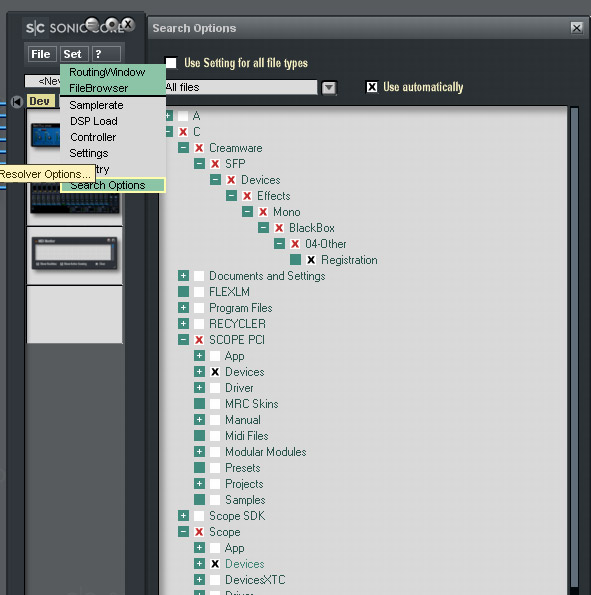

Menu Set/Search
Tick the deepest folder (it is useless to tick only disk "c:\" due to duplicates, + it is faster if it seraches in smaller places.

- RefRes5.jpg (62.42 KiB) Viewed 4131 times
