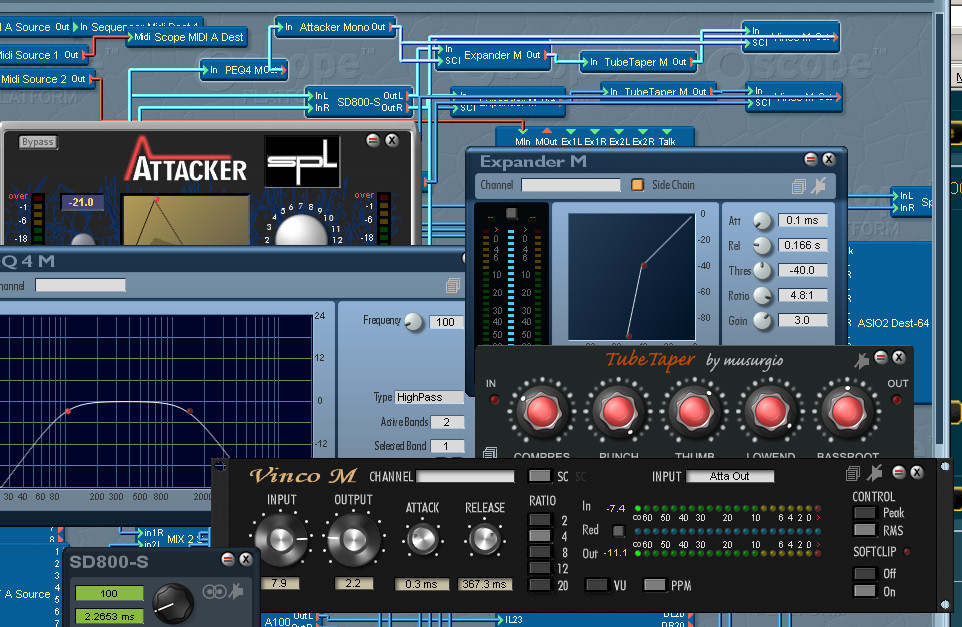

I've put these to use in an alternate fashion lately finding their use on drums a bit extreme and invasive on the original sound.
If you are happy with how the drum hits (i.e. kick, snare, toms) sound and you are only worried about bleed, I find the Attacker and alternatively the TD, invaluable as a side-chaining tool.
Consider a PEQ4 -> Attacker-stage (fully CW and attenuated not to clip) side-chaining an Expander -> Vinco-stage i.e.
Attacker virtually eliminates any bleed and thus giving you a nice trigger for your gate/expander and compressor. The side-chained compressor stage really brings out the drum hits and you will be surpriced on how little post-EQ you might require, if any at all.
Important! Don't forget to delay your processed drum-hit by +40 samples as a look-ahead to protect your transients. The TD i.e. introduces a 40 sample delay.
Likewise, all drum tracks in the mixer should be delayed to preserve phase-relations.

Re: SPL Transient Designer/Attacker (alternate use)
I would love a routing window jpeg of that.

You and your pictures  ..
ot as pretty as 5.0, but here goes. A current picture from that post-metal project.
..ot as pretty as 5.0, but here goes. A current picture from that post-metal project.
				- example.jpg (246.95 KiB) Viewed 5145 times
Thanks BuddyBuddy...
I was more interested in the routing than the device jpegs but having both was total Coolness................ankyu.
My pleasure.
The settings are obviously just in the ball park. It all depends on the tracking.

Most devices introduce no sample delay at all though they might be displaced onto different SHARCs which will cause a 1-2 sample delay.ChampionSound wrote:Thanks for this tip voidar, totally makes sense.
I wonder how one can calculate the sample delay of a certain fx module.
cheers Darcy
The SPL stuff has a 40 sample delay or so, give or take. You can use my free device Parallizer to manually test devices.
I plan on updating Parallizer soon.
I just today discovered how awesome the Impressor is. It can be configured as an expander and I feel it works better than the stock one; smoother and more control. Impressor also has look-ahead which replaces the SD800 in the project.
