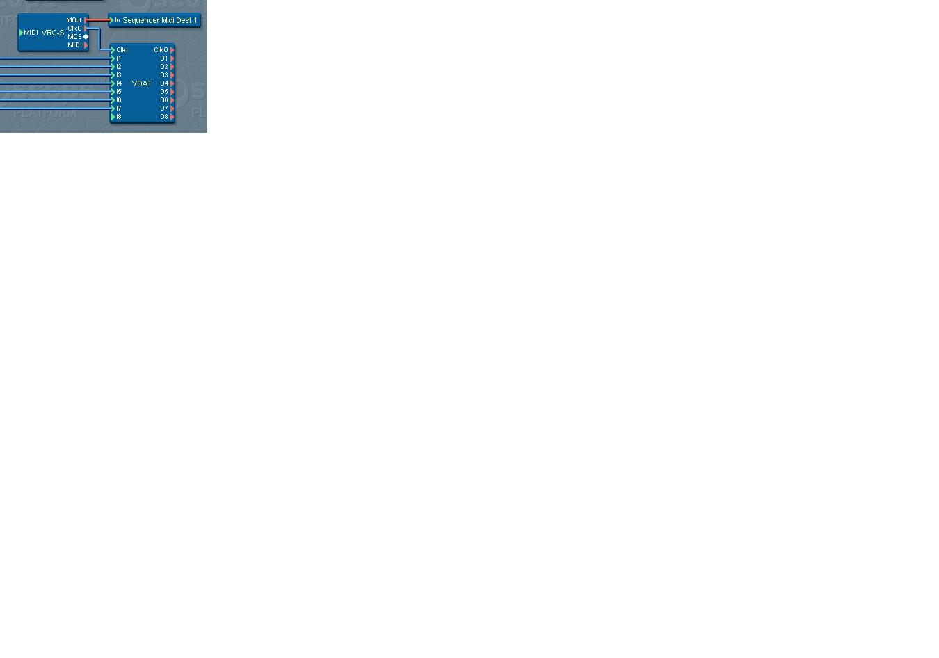

I´m trying to sync VDAT with Logic 5.5.1. (PC version)
The routing is shown below.
When I start the VRC-S, Logic´s transport window is counting up the correct SMPTE time, but the Sequencer doesn´t start.
The bar display keeps stucking at -8.1.1.1.
VDAT runs fine.
Any ideas ?
Thanks
- Ewald -

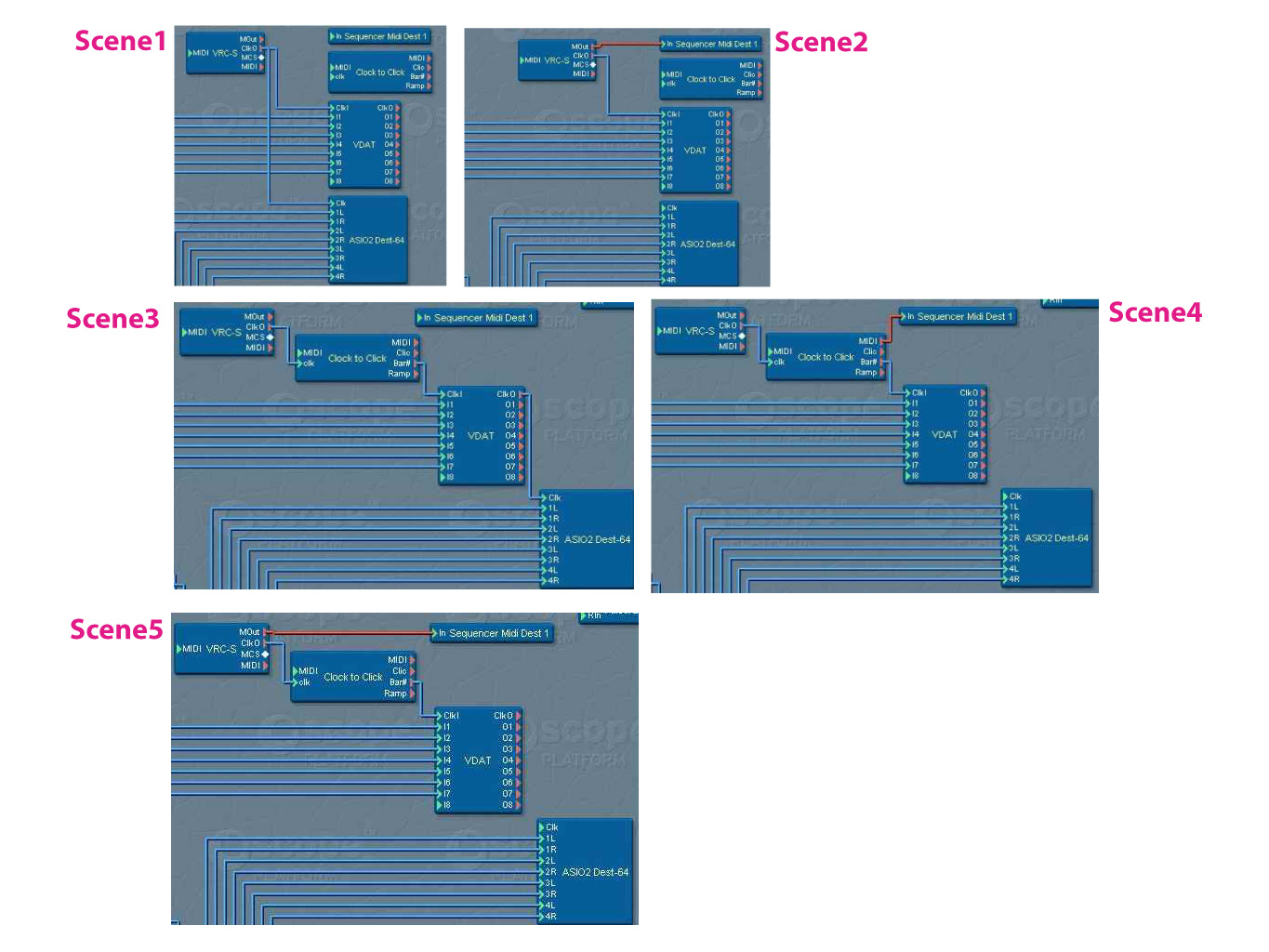

Probably I need more help.
Maybe you can tell me how to setup the routing in the SFP.
Please look at the screen copies below.
Can you tell me what I should go for ?
I found that only scene2 made Logic to follow the clock, but the problem with the hanging SPP is still there. All other routings don´t work.
Thank you very much.
- Ewald -

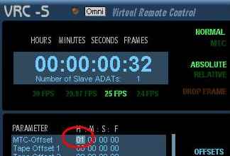

I have to configure 1hour MTC Offset in the VRC-S.
Logic has always 1 h offset on bar 1. (Don´t ask me why)
The Configuration in scene2 is working now.
-Ewald
