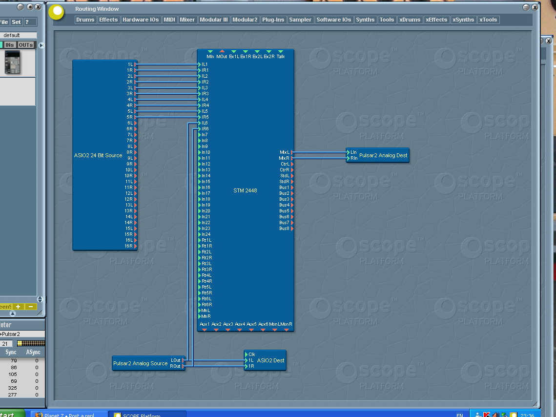

Try this project:
Now you should have:
JP-8000>Pulsar Analogue Inputs
In the project window this appears as Pulsar Analog Source. This is being fed to Cubase via ASIO. Now use the Busses in Cubase to feed this signal, say, to Buss 2. If you have something in Cubase you want to play along with route that to Buss 3 etc.

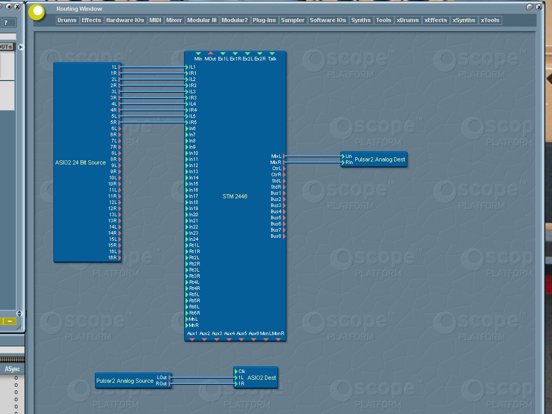

Alternatively try this project:
simple 2.jpg (206.1 KiB) Viewed 1976 times
Here the JP-8000 is going both to Cubase (via ASIO) and to Channel 6 (L+R) of the mixer. This way you can hear what you are playing as you record. This may be a better option depending upon your monitoring set-up.

you still need a sequencer midi source to a pulsar midi dest to carry the midi to the synth.
on the cubase track, you'll need to choose scope midi in/out1 as the output for the track, and of course the track and the synth need to be set to the same midi channel...
