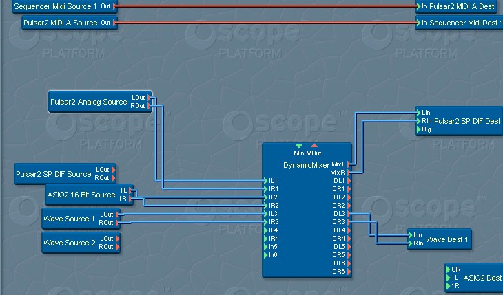

1- if i add/plugged pulsar analog source any of the mixer i hear a lot of deepnoise (nothing plugged to hardware even its own classic20).if i dont add it there is no deepnoise but i want to connect my analog mixer to creamware project's audio-in.

background noise currently audible when analog source connected to any of the mixer on routing window.

One easy thing to do, if you haven't, is to go to the LiveBar's menu, open the routing window, and disconnect or remove all the modules except the mixer and analog in and out.

when removed analog source module or just not connect it to mixer there is no noise.

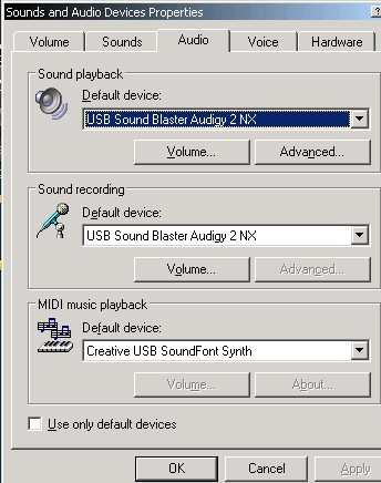

I wonder if some setting in the Windows Sounds and Audio devices of Control Panel could be putting some noise into the analog source.
Re: background noise
Posted: Thu Feb 26, 2009 1:24 pm
by electrolover
Pete wrote:I wonder if some setting in the Windows Sounds and Audio devices of Control Panel could be putting some noise into the analog source.
as seen the attached picture nothing related about scope.
scope would be for analog in and and asio (for vsti's) only. audio signal goes to sb audigy nx with toslink optical.
basically music for scope all other things for audigy nx but all sounds can hear from audigy because speakers and headphones connected to audigy.

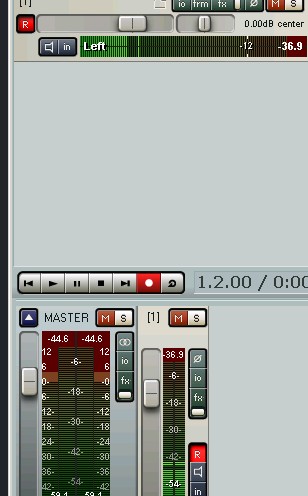

noise audio
vu

It would be easy to select all Scope devices in the Windows control panel, and see if the noise stops. You might check using the analog dest, too.
Sounds like your noise is from the computer's i/o bus's, and the Soundblaster's one thing that uses it. You could try the volume sliders of the Soundblaster, and see if that changes anything.
