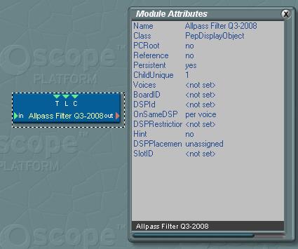

Here's a little test of 2 different lowpass filter designs - which one is the best implementation regarding low frequency response etc.? Please modulate the parameters all you can.
Unfortunately the C1 & C2 are not calibrated - so they wont match - that will of course make the test abit more difficult.
C1 = C2 = Range [0 ; MAX]
http://www.relab.dk/Filter.rar (new upload - should be easier to follow)
Cheers
Cheers

New upload - should be easier to follow.

I have uploaded yet another version - now including the Chamberlin form (LP3) - http://www.relab.dk/Filter.rar
The LP1 form is a low sensitive structure - better response than LP2 with modulation.
