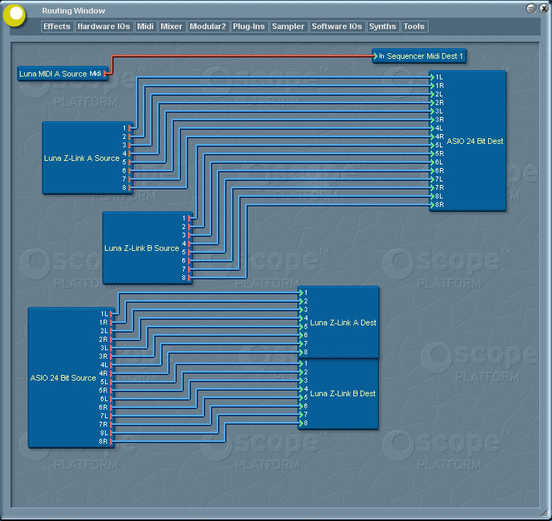

So i have an a16 ultra connected to a scope 3 dsp home card with the z link expansion card. Z link A is plugged into the mother PCI card, and Z link B goes into the expansion card. I verified this by going to the samplerate window within the scope platform. The red light by Z link A is illuminated while the Z link B sync remains dark. Any clue as to how i can go about fixing this? im going to be recording in a couple of weeks and would love to get more than 8 i/o's.

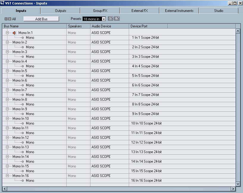

oh and here is a shot of my vst connections in nuendo.

well, not the ideal way test it ...
if you're concerned about the hardware, restrict the environment to hardware and to an absolute minimum of software.
Just connect the Z-Link ports to a virtual mixer in the Scope environment and check which channels carry a signal.
Usually the stuff fails in groups of 8, so an input signal on port 1 and 9 should do the job
Route the respective outputs (physically) back to some other channels (say 2 and 10)
and check if the meters on the mixer display the signal
cheers and good luck, Tom

yes, try the ports with a scope mixer first. and check if the z-link sync led locks to B if you just hook one cable to the z-link port on the adat expansion.
if it does (and the a16U shows synching via z-link), and you have verified that scope is master and the a16u slave (I'd prefer that), the cables should at least be fine.
there is a small chance that the unit mutes completely if not both z-link channels are in sync with each other, but that should only happen if you hook the unit to a non-stdm-coupled bunch of scope cards. still could be an indicator that the ribbon cable might be faulty. you could try to get hands on another luna and hook it via stdm to the other.

so the first thing i did was unplug the z link A on the main scope card (so now the only z link connected is B going into the adat expansion. now, with the a16u set to slave, it is not receiving sync at all and the z link word clock indicator lights red. In addition, neither of the z link leds under the samplerate menu are lighting up. Next, i switched firewire cables to make sure it wasn't a faulty cable. Sure enough, they both carry signal.
Next i routed z link ch 1(a) to a 1632 mixer, got signal there. I routed z link ch 9(b) to the mixer, but couldn't get any signal.
