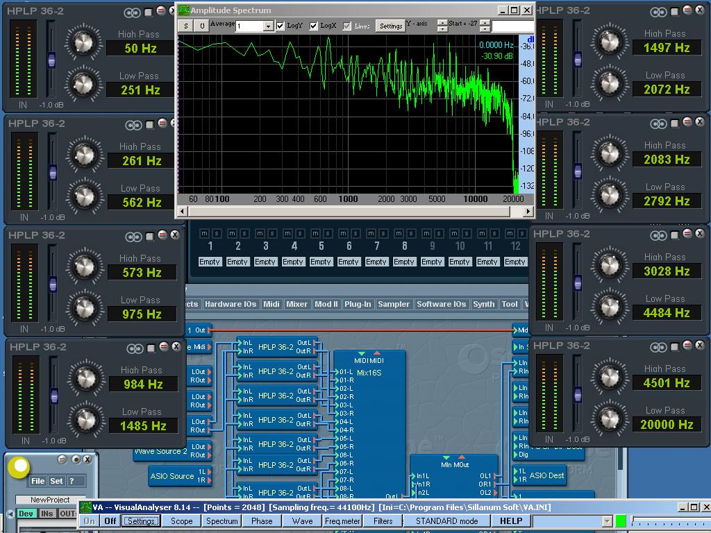

8 parallel bands of Xtreme Cut would eat up a lot of dsp (you wouldn't get them on anything less than a 14 dsp card), but you could experiment (emphasis on experiment) with something like what's pictured using HPLP devices (low on dsp) & a simple low dsp stereo channel mixer like the MIX-16S that my brother sharc made (it has mutes & solos).
Mark
edit - ignore those frequencies though, since I just threw those in there quickly.
							Mark

Re: Band EQ/Filter for monitoring
Thanks I will give that a go.
I appreciate your help.
No problem at all. One of the most important things to remember if you're experimenting with this is that you've got variables on the crossover frequencies that you could benefit from or if not analyzing properly could be problematic. For example with the LP freq of a band & the HP freq of the next band separated enough you can create quite severe cuts in a particular frequency range, but doing that could work for you or against you depending on what you're trying to do. If you don't want to cut any frequencies at all you'll need to analyze the effect of your frequency settings in detail, which is why I said to ignore the frequency settings that I threw in there quickly.
Mark
						Mark
