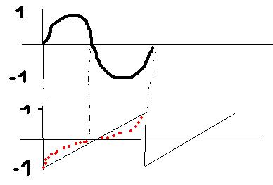

but by the way i found out something
the sync signal is only a ramp ( startes from -1 up to 1 ) ( see pic )
and its also possibel to mainpulate this signal
sync Master out -> ring mod I1
sync Master out -> bipolar to unipolar -> ring mod I2
ring mod Out -> Sync Slave ( see pic red ) )
i also tied a curve table to change the sync signal ( but remember curve signal output is 0-1 and not -1 to 1 => also use a mixer to add -0,5 and multiply the result with 2 ( Gain 12 DB )
=> clean OSC sound if sync singal is linear - totaly dameged sounds if sync signal is non linare and/or with an offset ...)
however ...i never tried to change sync signals, buts possibe
cheers widy
pic)
1)sin osc
2)sync signal
lg widy
Neutron
Posts: 2274
Re: multi osc with m sync and s sync
Post by Neutron »
try mixing a sin with its own sync and then using that as the sync for something else. then you can use the mix to control the shape of the output. (which could easilly be modulated with mixmodulator.
widy
Posts: 175
Joined: Wed Apr 07, 2004 4:00 pm
Location: Austria-Graz
Post by widy »
thx for the tip .. i will try this at home :)
cherrs widy
