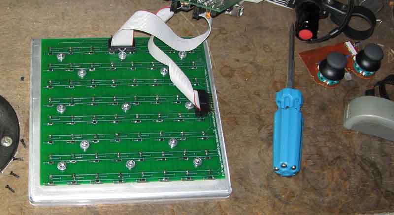

They arrived!
Now i have to get some LEDs and solder a zillion SMD diodes. mind you they are not the really tiny ones, so it should be fine.

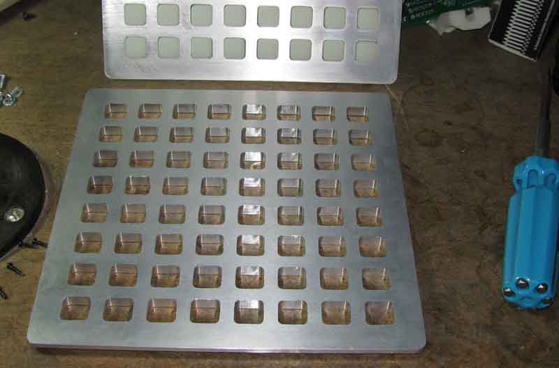

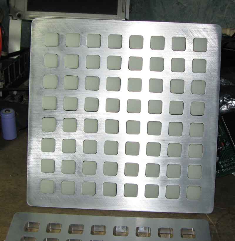

Front plates came in. I went to a web site where machinists bid on small jobs, it worked out great.
they are CNC machined out of solid 1/4" 6061 aluminum.
I have been using them just with the bare circuit boards anyways
now to make some nice boxes for them.

Lookin' good Neutron!! Those Alu panels look seriously solid.
It would be quite time consuming & would need to be done asap, but you could get a really nice finish on the top corner edge of the button apertures by lightly filing them (with a very fine toothed needle file), then burnishing them to get a nice fine polished edge.
Mark
Mark
Re: Monomes!
In fact, a fine deburring tool would be much quicker than a needle file for creating a fine chamfer.
