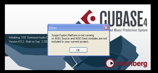

Hi there everybody....
Yesterday XTC did work fine....today i got this message ( see the picture......)
Does anybody have a clue...???

Hallo
I just got the same problem.
For a couple of days, XTC is no longer working
Didn't change anything.
Sfp mode works, cubase works, but it doesn't start the XTC-App.
Something with the new Cubase-version, which allows driverchange while running?

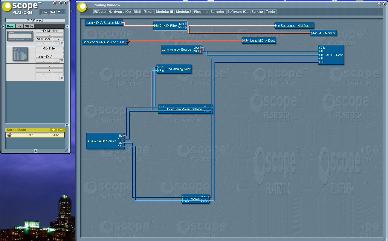

Hi, Iam not a Profi like Garyb or Stardust Image , but I have an Idea:
Check your Asio settings in Cubase. When theres no Asio to choose. Close Cubase- Open Scope - Load XTCProject.pro (Its the Default settings of XTC) and look if Asio-Dest & Asio-Source are connected with something. If not, here is something to try that maybe helps:
After all Connectings: Overwrite XTCproject.pro- Close Scope- Open Cubase - Go to Asio Settings in Cubase & Choose Asio (I hope)
