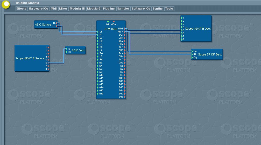

I try XTC mode with this connections. Is it right?

looks right..
well first of all, try opening the project you posted, and open cubase, still leaving sfp running with the project.. do you have any sound?? if not, the soundcard is not the problem.

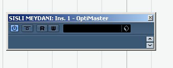

And I try open effect(optimaster) on cubase , but it open like this.

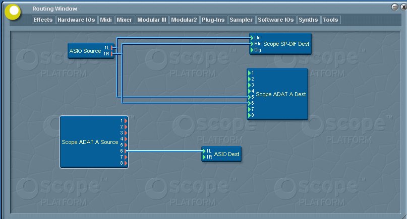

First of all, install sfp with the xtc mode field ticked.
there is SFP mode and XTC mode. You can't run both of them at the same time.If you want to run things in xtc mode you have to close sfp
You can though, test your XTc project.pro: open sfp, open your xtcproject.pro, i would leave out the mixer ( as stardust pointed out), and connect the asio outs direct to your scope adat and scope spdif. ( just to test things.) open cubase, select the ASio scope driver in cubase, playback some random audio and see if you have sound..
If you have sound, it works.save your xtcproject.pro file
Now close sfp.
open cubase. ( it probably wont recognise your audiodrivers first time), select the asio driver in cubase. restart cubase.
Now watch for the xtc logo when cubase is opening!

yaeh, I know XTC mode and SFP normal mode different and when I try to works on XTC mode I close the scope program.I checked XTC mode enable.
So I do everythig.I can hear sound while scope working normal mode.But When I close scope Platform and open cubase ,Ican't hear sound.What s wrong, I don't understand :(
Everything like this.

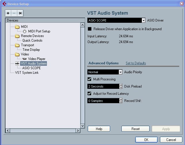

Device setup on cubase
DEVICE SETUP.jpg (53.79 KiB) Viewed 796 times

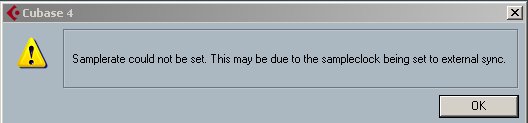

When I open cubase I take this massege.
SAMPLERATE EROR.jpg (11.27 KiB) Viewed 796 times

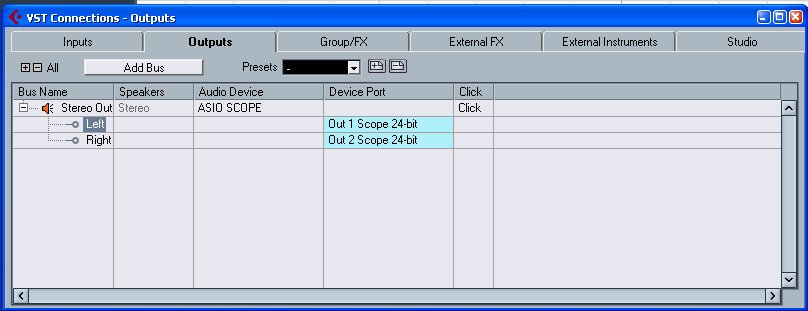

and my outputs...
If am I correct ,I will remove scope and re-setup again :(

go to device setup, and to asio scope. then reset/refresh the ins/outs, go to connection setup (your screenshot), configure the new ins/outs..and restart cubase..

Re: XTC problem
the "samplerate could not be set" message occurs when the Scope samplerate is not what the last samplerate that cubase operated in, or if it is not the same samplerate as the project which is being opened. changing the samplerate in scope or cubase will fix the problem.
