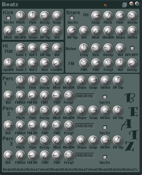

Ok, here's the full release, lotsa controls for you to play with.
Gotta thank Brazda lui Novac for all the assistance and testing.
Knobz by Shroomz.
This is an analog style drum machine, kick, snare, hihat and 3 percussions.
Anywhere you see DK, understand it's "decay" (before somebody asks "what does DK stand for?")
Mod, Mod DK and Slope all work together, slope is the slope of the Mod decay.
DK Slp, is the slope for the amp env decay.
Trigger notes are GM midi, percussion's are on tom notes F1, G1 and A1.
The 2 tone and vol controls for the hihat are for 2 different filters, 1 is HPF and 2 is BPF so you can mix and match them as wanted.
I had a pan control but figured it wasn't that necessary and turned it into the DK Slope control because I had no room left to add it to the gui for the kick and hihat and I didn't want to shift everything around. I'm sure most will use the separate outputs anyways so the pan is kind of useless.
I'm not sure how to post a screenshot, if somebody could assist in that please? (and how do you post a screenshot?)
Enjoy,
Mark

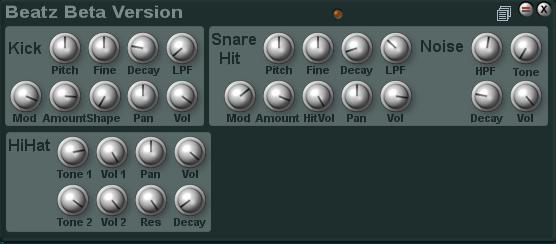

I was looking for a device like this that sounded different, not like EDS16i, so thank you for his one. I also like the look and the easy interface. However I have some suggestions:
1. on the kick I would take out the LPF and instead I would put in a pitch decay or a pitch AD envelope with amount, right now the amount button acts like a resonance for the LPF. You can still keep the LPF after the shaper, but to me the it does not sound like a shaper I am used to hear. It does not help to do a punchy kick drum, but perhaps it will be better after the pitch envelope implementation. The mod acts more like a re-triggered LFO and not like a decay envelope for the LPF, because it delays the sound a bit, and it's not punchy.
2. I like the snare and the controls, but again the amount button does the resonance for the LPF. Just change the label. The mod acts like in the kick module, check the envelope too. It's a classic snare setup, what I would like to hear is a different sound, add an oscillator for FM type of sounds, or even two, and play with connections, envelopes and amounts. You can obtain a lot of other new type of sounds with it, instead of having a classical snare setup. (which is great but already done). After you'll do that all you will need is just copy the snare module another 2 or 3 times and you'll have the hihats and other new type of sounds.
3. nothing to say about the hihat module, it sounds very good and it does the job.
That being said, I think you did a great job for your first synth module, and I like the fact that it can be used easily at 96Khz. When it's finished I promise I will do some presets for it.
Cheers,
Victor

Thanks for the feedback, I wasn't overly happy with the kick myself, I'll check into what you said and see if things improve, that's why I posted it, for feedback.

and here is the screenshot
				- Beatz final.JPG (52.94 KiB) Viewed 12133 times
