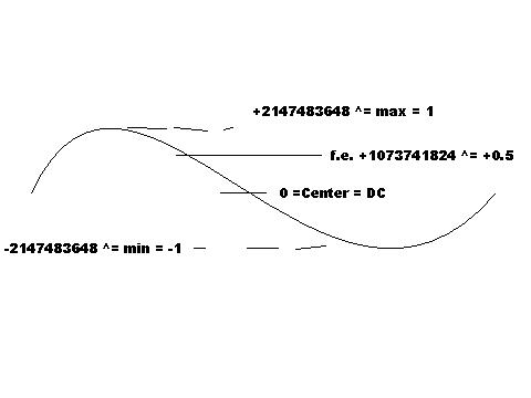

a little illustration picture for basic understanding....
hope that helps.
signed unsigned_explain.JPG (11.6 KiB) Viewed 3687 times
hifiboom
Posts: 2057
Location: Germany, Munich
Re: DSP arithmatic. Divisio?
Post by hifiboom »
so if you multiply a wavefrom with ~1073741824 it is the same like multiplying with 0,5 or halfing the amplitude.
So a multiplyer is nothing else like a gain leveler if you input a fixed number at one input....
if you add too audio streams the multiplier is a ringmodulator.... sadly not aliasing free. :) :P
a multiply of a waveform with a fixed negative value flips the original wave source. (like the modular diode) positive values get negative and negative get positive.
