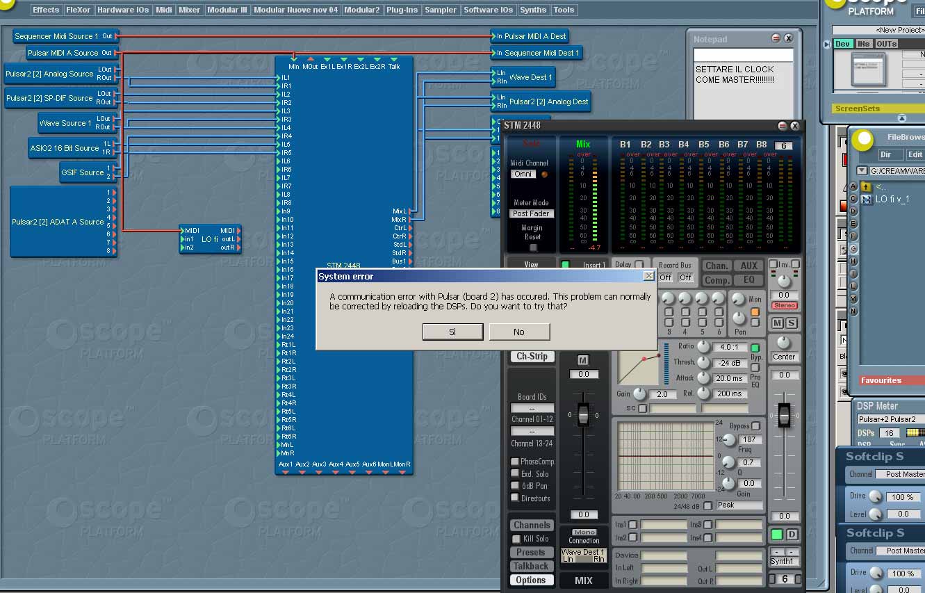

Oke... I cannot solve this problem.
When I load i.e. Vectron I obtain this message.
A lot of others devices works ok, but some like Vectron (more than 6 voices), loFi, etc. not!
I've poolished STDM cables, connectors, I've sprayed with contact cleaner... but nothing.
It's not a DSP problem (I think).
I press OK 2 times then all system must be closed because mute!
Any opinion?
Thanks.

Hi
In the ScreenShot The STM Boards-assign Are UnSeen
* If theScope [The 14 dsp Board] is the 1'st in your CEST.INI
Try assigning "BIG Devs DSP-Hungry" Into This board, and the Other devs InTo OtherBorrds'DSPs

This sounds like the same problem I described about a month ago in the thread on the stm24/48. I never completely resolved the problem. I was running 3 pulsar cards, all pulsar I(4 dsp cards). I would get input channels, or aux outs that would act muted. When I tried changing the channels to board assigments I would get the same error you are getting.
I got a pulsar 2 with 6 dsps on ebay and replaced board one. The same problem. The only way I could get it to work was to remove one of the pulsar cards. I am currently running with 1 - 6 dsp and 1 - 4 dsp board. I sent an email to creamware support and included a project that is giving me problems. They replied it was passed on to an engineer but would not be working on it until atleast August 12.

SOLVED!!! :D
Just deleted /APP/DSP -> all DSPS (with SFP closed!!!)
the replaced with fresh ones... and all works ok :)
Anyway it's a very strange behaviour...
