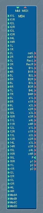

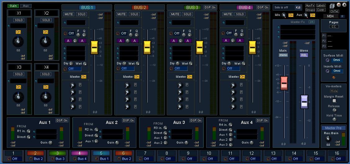

On the other hand, SpaceF's MB4 mixer might be just what you're looking for! It's a BUSS (BUS?) mixer, so it's got some special treats:
On the mixer side, you get 4 stereo channels, each with 4 inserts, 4 other stereo channels with a single insert, plus 4 AUX channels with 2 inserts each.
On the input side, you can connect 16 stereo channels, and route each one to each of the 4 Mixer Channels. So you can have all your inputs connected at the same time, and choose which ones to listen or to mute. It's that colorful little strip at the bottom of the pic.
Different setups can be selected via MIDI, too.
I believe this would allow you to do what you wish, and there are many other interesting features on these mixers, well worth a look.

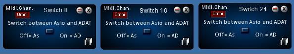

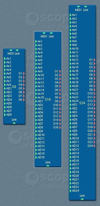

Hey, 19b, I seem to have exactly the device you were asking for... It's called switch 8-all (ASIO/ADAT switcher), and does exactly what you need - plus you can have it in 16 and 24 channel varieties.
Take a look at the pics below - I can't remember where they're from, as I hadn't even used them, but they look suspiciously SpaceF-Blue. Anyway, If they turn out to be free, I don't mind sending them to you, as long as it's OK with the author. No idea about XTC compatiblity. there was an old module called "switch-it" that worked in XTC, though it was only mono, if I remember right...
Cheers,
T
edit: there are also 2 free switch modules from wolf (4x and 8x): http://wolf-audio.com/wad/freebies/Entr ... tches.html

i have already tried the space f( in the picture) switch modules... and they dont work in xtc mode.. they dont let any sound through at all :cry:
But i will try the link you gave me!!
thanks! :)

They are free, I made them for a request.
If someone mails them to me i can re-upload them to device section.
