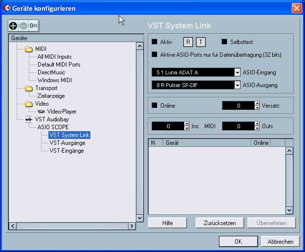

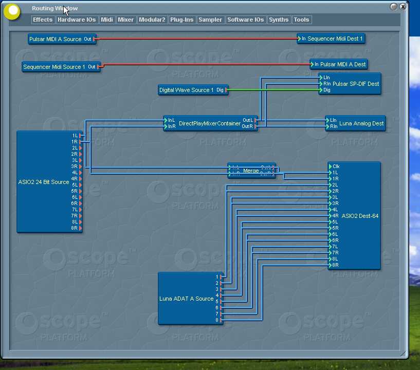

I Think it's correctly enabled. Here are the connections in Scope and the routing in Cubase (there are two SPDIF from the Pulsar but there is no difference which one I choose).
				- XTC Project.jpg (51.79 KiB) Viewed 4874 times
				- Routing Cubase.jpg (34.73 KiB) Viewed 4874 times

You should not use system link for mix output,  it is normally for linking two cubase machines altogether! They do not carry audio data but "something " insuring data and synch communicatiion.
VST Inputs and VST outputs are your cubase input / outputs. Check that they are routed correctly (cubase output to the ASIO output connected to spdif) .
cheers
cheers
