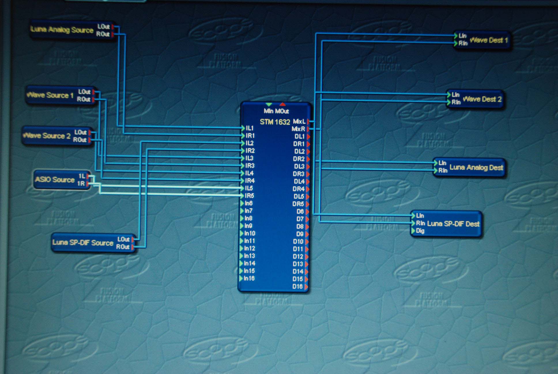

- Here's an example of what should work
- SPDIF-ASIO.JPG (5.85 KiB) Viewed 2511 times

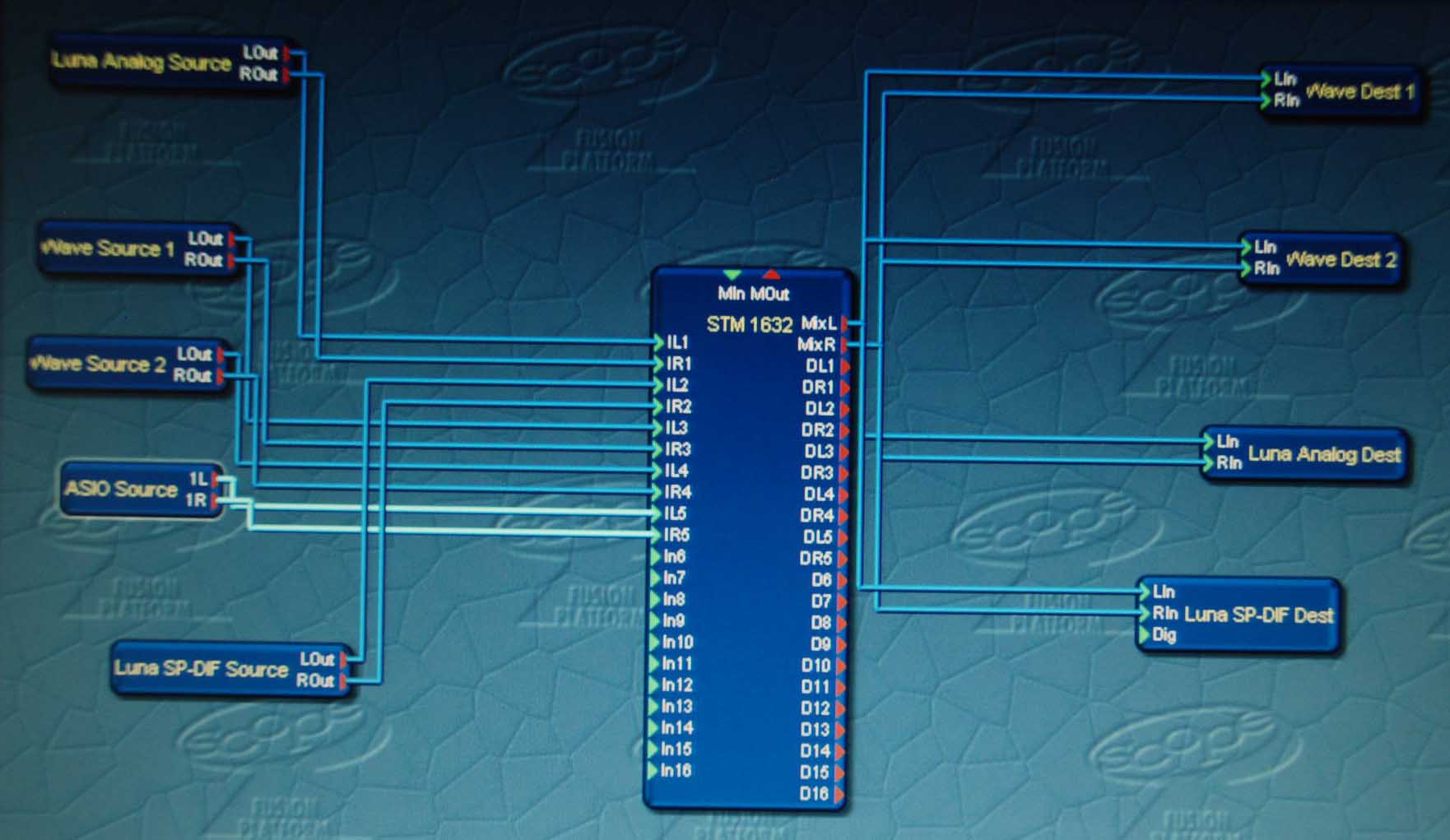

Hi
Here is a screen shot
Which ASIO module is the Yamaha 01x , knowing that i am using the digital in/out of the Yamaha into the scope. Cubase and other sound is playing back from the computer into the mixer out thorought the monitors.
But i cannot record into cubase
- scope.jpg (195.1 KiB) Viewed 2446 times
