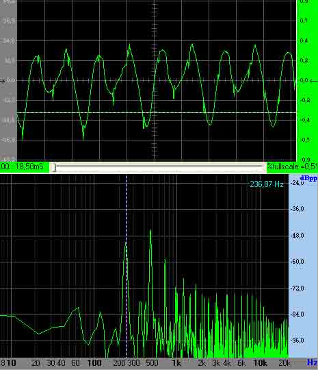

Ok, I just had the Philips TFT here to make some try.
1) the noise is going on whatever orientation the AC plug has
2) no noise on the DAW using the monitor with the other PC, connected to the same AC socket
3) the pitch of the noise don't change using different refresh rate
4) the noise is present at Luna box output even if SFP ain't running
5) the noise do is present when the screen is black but the backlight is on, it disappears when backlight is off
these are waveform and spectrum of the noise I picked up at Lunabox output:
Cochise
Posts: 1305
Post by Cochise »
At now I don't think changing the cable will solve.
The other cables here are a bit thicker, but they also are older...
The Philips' cable has small 'nuts' (sorry, don't know the name of those things) at both the ends and it is marked: AWM E101344 STYLE 20276 VW-1 80°C 30V SPACE SHUTTLE-D.

I get something called coil whine from my LCD monitors - it's a right nuisance! But maybe that's what you're experiencing? It's fairly high-pitched, and it apparently has something to do with cheap power supplies (my monitors are both cheap, and have those in-line power supplies, a bit like laptops).
In my case it definitely isn't DC hum (balanced cables throughout, no 50Hz hum, active monitors and LCDs all sharing the same AC power source). Like you, it stops when the monitors go black (either screensaver, or, like you mentioned, when the screens blink off and on again during startup, and also just when you turn the monitors off). It doesn't have any effect on recorded audio, it's just interference between the monitors and the LCD screens' power supplies.
It's also a real bitch.
Does that sound like what might be happening to you?
Posts: 8467
oh yeah, I hear you - it's a real pity... :roll:
a MacBook Pro (the old 15" model) would just drive me nuts - I was totally surprised about the beeeep level when I had to service one from the office and took it home.
My TFT starts to emit hearable sounds when I set the brightness too low, i.e changing brightness and contrast might drive it out of the hearing range.
Fortunately I don't have any of the noise in my guitar gear, except when the TFT would return from powersaving I hear the 'whining', too

@ chriskorff
Something very similar is happening here with the Philips 170S. Just the noise fundamental freq is lower, as you can see.
I just checked the screen in a ordinary PC configuration (onboard audio + Creative 2.1) and there's no noise...
