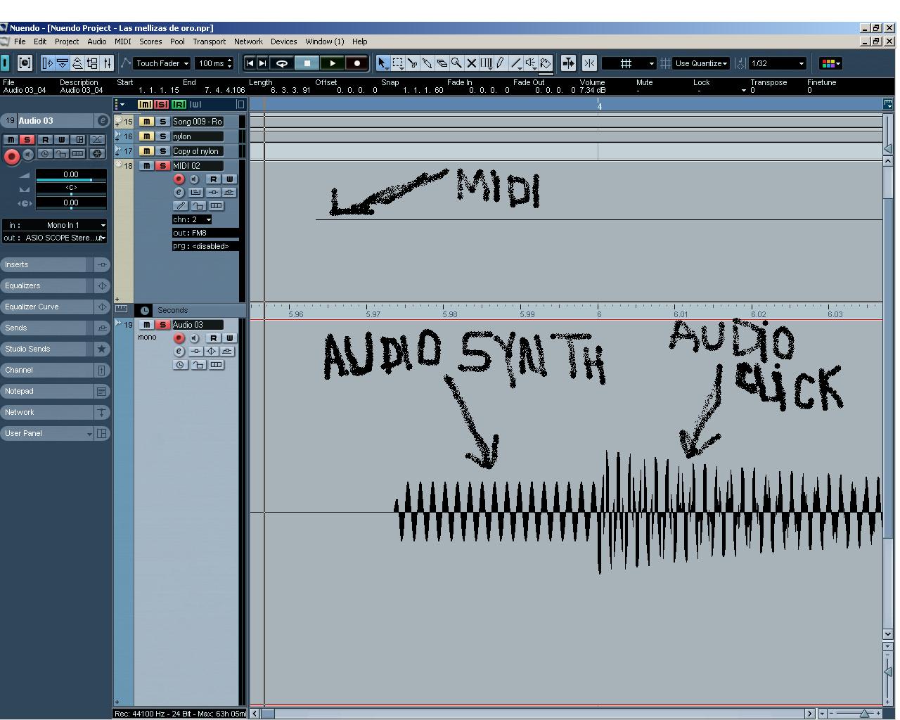

playing with click (beeps)<br />during the record is ok<br />but after rec ,,,, midi notes appear before (not delay)
MIDI PROBLEMS.JPG (181.23 KiB) Viewed 2506 times

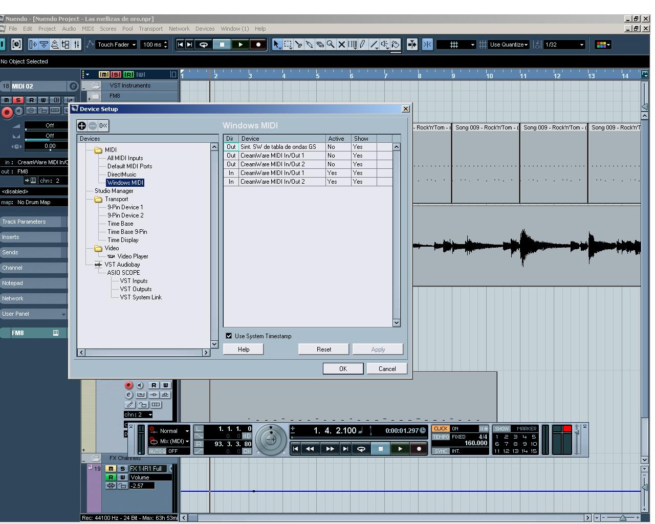

somewhere in the advanced settings,"use system timestamp"......

"Use system timestamp" is on(active)

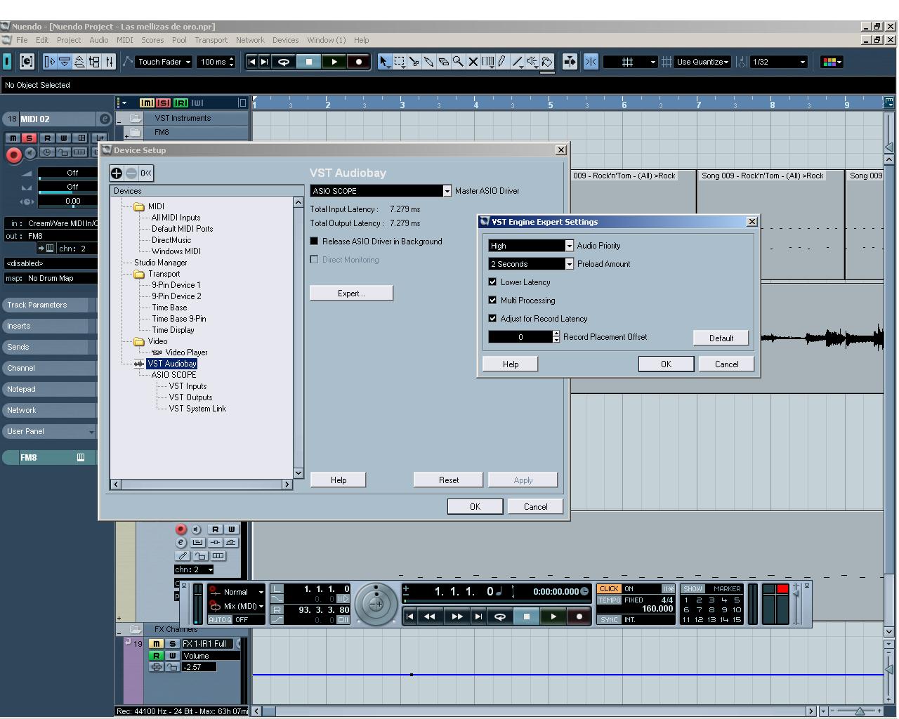

in your device setup in cubase check your input and output latency on your scope asio page, are they the same? If not you'll need to upgrade cubase, I think this was a problem with sx3 (if I remember right), get the latest version of sx3 you can and install that.
overpeak
Posts: 9
Joined: Tue May 06, 2008 5:48 am
Post by overpeak »
Yes input and output latency is the same!
Thanks!! Jah Servant

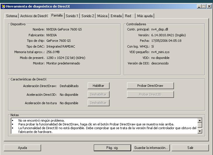

try the dxdraw solution:
http://www.planetz.com/phpBB2/viewtopic ... +timestamp
you can try unchecking the system timestamp as well...
overpeak
Posts: 9
Post by overpeak »
Excellent post!! thank you very much Garyb!!!
I had thinking that the problem can be grafic..but..
I don´t Know what I do.
Thanks!!

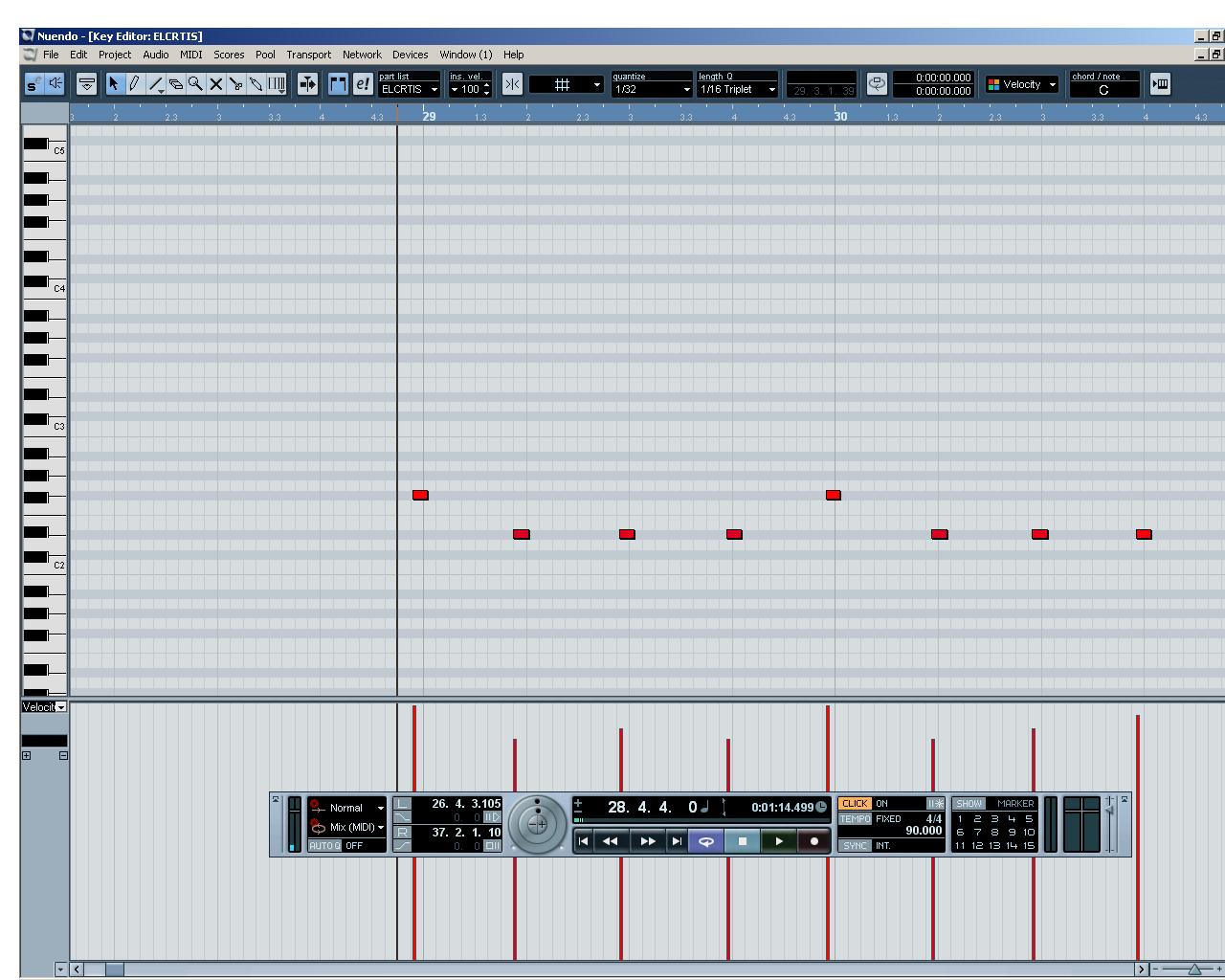

After 2 Hours this happened:
after 2 hours (inverse situation).JPG (126.05 KiB) Viewed 2437 times

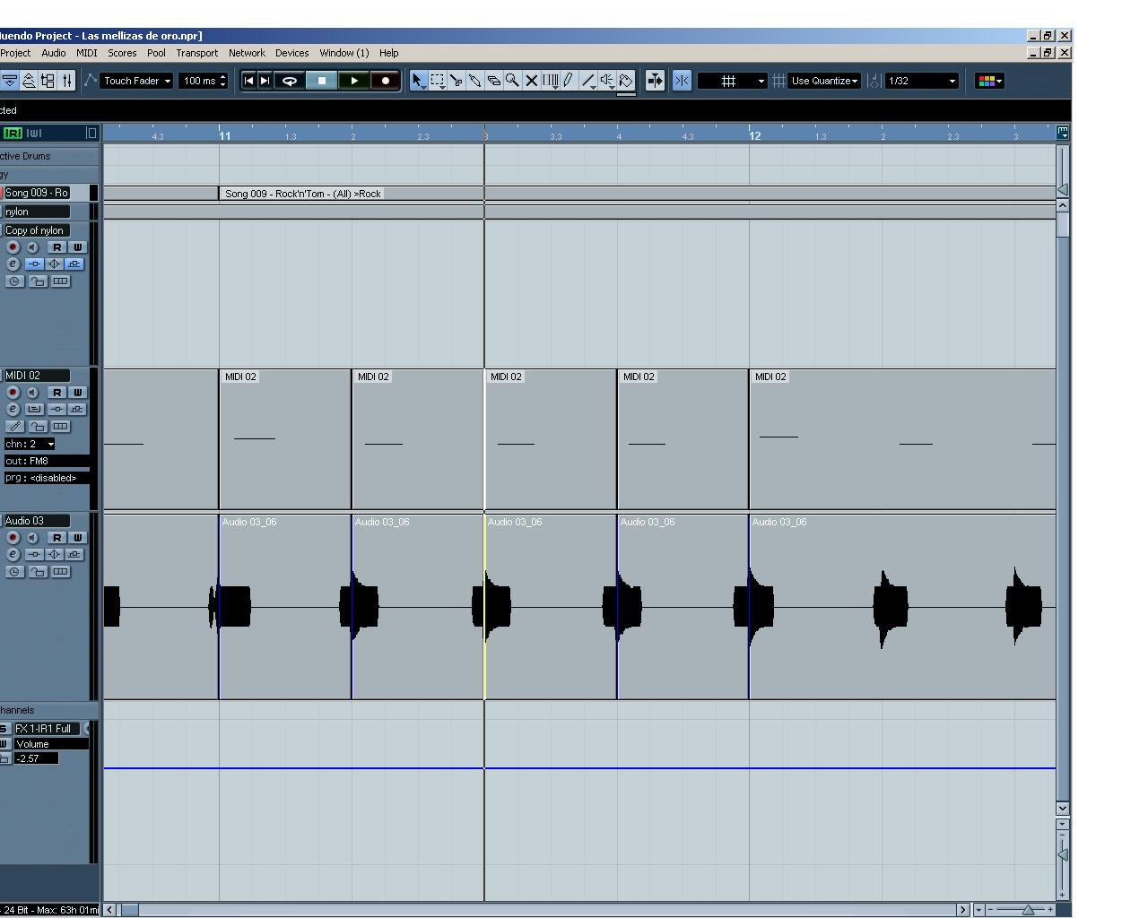

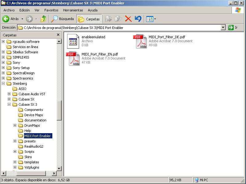

I've had this anticipated placement of recorded MIDI issue and it was cured by moving the "Ignoreportfilter" (or something similar) out from where it is located now in the Cubase SX directory (make a folder and put it in). This will allow all the emulated MIDI ports reappear in the Device settings of Cubase and you can chose the ones that work well. It has been previously reported here...somewhere.
Before the latest SX3 versions the ignoreportfilter was alkready put in a place where inactive and it had to be copied where it is now to work. From a certain version they decided to make it active, but it has been a mistake.
Sorry I wasn't too precise, but I'm not in the studio at the moment. I'm quite sure that this is the problem though.

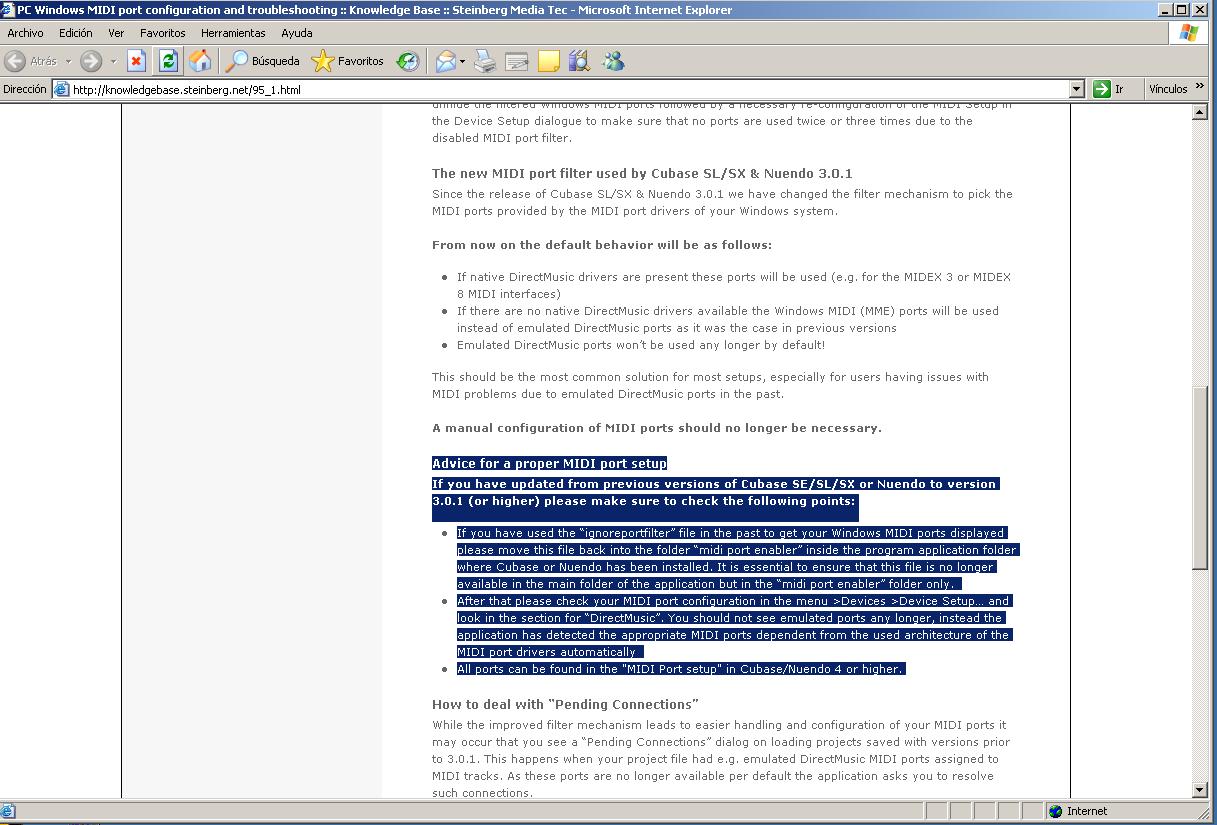

there you go, that's a good one. the steinberg knowledgebase has that info...

I ve tried search this file into the Nuendo files...but in v3.2 it not found...yes into cubase 3.1.1
I read the steinberg knowledgbase
http://knowledgebase.steinberg.net/5_1.html
but for me is very confuse...sorry

Now Im here...and there are anticipated placements of recorded MIDI issue
VERSION 3.1.1
VERSION 3.1.1
midiportfilter_cubase sx3.JPG (64.88 KiB) Viewed 2368 times

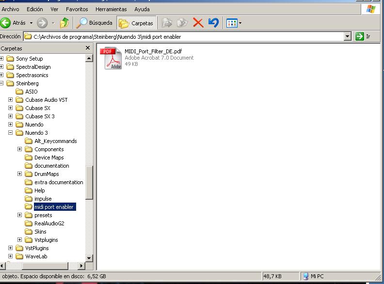

VERSION 3.2
VERSION 3.2
the file in question is "ignoreportfilter". if this file is in the root cubase or nuendo folder, it needs to be moved to the "MIDI port enabler" folder.
for the dxdraw solution, try both enabled and disabled.

This file..."ignoreportfilter" (0kb) is only in Cubase sx3 root folder....in MIDI PORT ENABLER FOLDER....
Nuendo 3.2 (I ve install both) isn´t in PORT ENABLER FOLDER (nuendo folder) (Picture attachment above)
