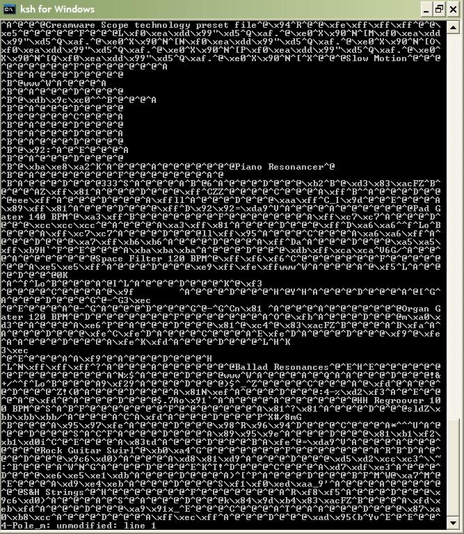

Here's where we are at the moment:
Installed two Unix-like packages into Windows XP. Shell is my preferred environment. The first one is called UWin, and is old. The second one, which I've used for development, is called Msys (we don't need it here, but I mention it because it is better supported imo)
Copied a preset file, 4-Pole M.pre, into the UWin environment, and renamed it, making it easier to work with (from 4-Pole M.pre to 4-Pole_M.pre).
In Unix, there is a command called 'file', which examines the first few bytes of any file. It does its best to accurately report the contents of the file. Anyone, please PM me for details on how it works. I used to teach this stuff.
Uwin's file command reports that the preset file is gzipped:
$ file 4-Pole_M.pre
4-Pole_M.pre: gzip compressed data, win/32, deflate
Let's try unpacking:
$ cp 4-Pole_M.pre 4-Pole_M.gz # for convenience with gunzip
$ gunzip 4-Pole_M.gz
Well, It sure is. Gunzip exits with an exit status of 0 (no problems) and 4-Pole_M appears, with no file extensions.
$ vi 4-Pole_M (attached screenshot)
Unpacked, the factory file's preset names are visible. Almost as important, it looks like it has a repeatable pattern. Note that "Piano Resonancer" is offset a certain amount, then further down you'll see "Ballad Resonances", offset by the same number of characters from the left.
Vi is Not the way to go when pulling the names out of the file, of course
I'll be back to calculate the offsets of the patch names.
-cap

Continuing, using the Unix "od" (octal dump) command, to determine the byte offsets of the preset names.
Attached is the result of running the following:
$ od -c -A d 4-Pole_M > 4-Pole_M.doc # .doc b/c it opens in Wordpad on Windows to preserve the columns
Looking at the locations (byte offsets) of the beginning of each preset name, here's the pattern of the first 7:
163: Slow Motion
343: Piano Resonancer
527: Pad Gater 140 BPM
711: Space Filter 120 BPM
903: Organ Gater 120 BPM
1087: Ballad Resonances
1271: HH Regroover 100 BPM
In offsets from the immediately previous preset name:
NaN
180
184
184
192
184
184
So, this isn't consistent. Next: looking at the offsets, using the null byte that ends the preset name field.
Back shortly - cap

Further results, using the trailing null byte of the first 7 preset names.
174: Slow Motion
359: Piano Resonancer
544: Pad Gater 140 BPM
731: Space Filter 120 BPM
922: Organ Gater 120 BPM
1104: Ballad Resonances
1291: HH Regroover 100 BPM
NaN
185
185
187
191
182
187
This means (apparently) there is not an absolute consistency of preset record sizes. In other words, the presets may possibly vary, in terms of their sizes in the preset file.
Still not done - MusicWonk looks awesome!
However, I think I need a beer or two, while I rest my eyeballs.
The next step is to look for preset delimiter byte sequences, and see if the preset names align to those. This needs to be portable, i.e. the same algorithm should work on any device's preset file. I would expect that the presets for other devs are not identical, size wise, than this randomly chosen one.
Glad to help, even if we can't ultimately get this solved.
