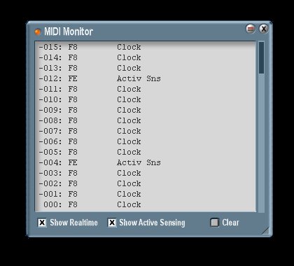

The crashes were exactly as mentioned by many users, the audio gets stuck in a loop and soon after the PC freezes. The only remedy was to reboot the PC. Now my system is stable even with Active Sync and Clock Out signals turned on.

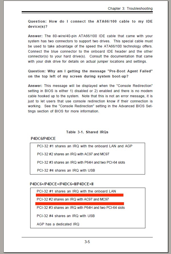

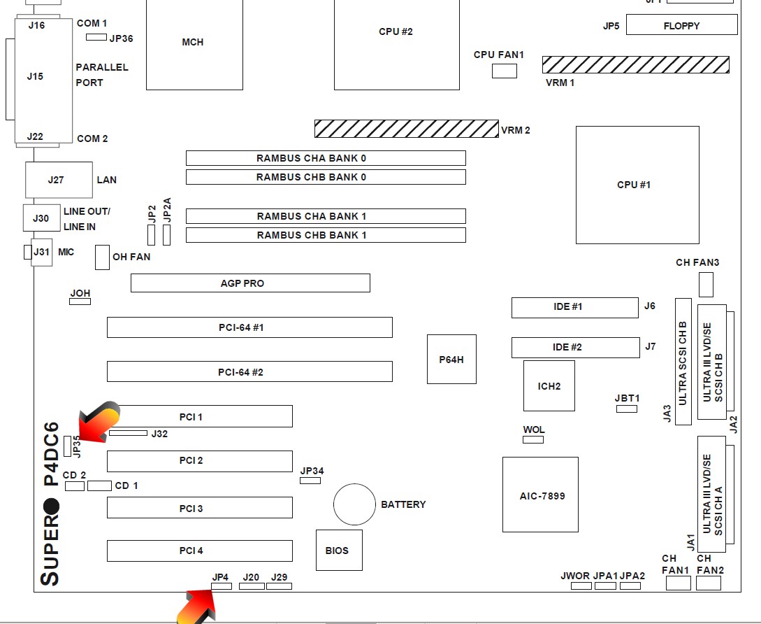

My system is a Supermicro P4DC6+, dual Xeon 2.8GHz with ACPI enabled (don't have to disable ACPI). The fix was to disable onboard audio and LAN using two respective jumper pins. Don't look at the IRQ sharing in Windows, get the manual of the motherboard and check for a statment regarding the sharing of IRQ on the PCI slots you are interested in. See the attached picture. I had the Scope SRB in Slot 1 and Pulsar 2 in Slot 2 and even with the audio device turned off in the BIOS it still would crash. Although that could have been also because of the LAN sharing an IRQ with Pulsar, I don't know which of those two slots was the problem because I disabled both the AC7 and LAN at the same time.

- And the dreaded Active Sens and Clock signals.

- This is the location of the Jumper Pins that enable or disable the AC97 onboard audio (JP4) and LAN (JP35)

- Section of the Supermicro P4DC6+ motherboard manual showing which devices share the IRQs on the PCI slots.

I had the AC97 audio disabled in the BIOS before and I still had crashes. I disabled the LAN because it shared an IRQ on PCI slot #1.valis wrote:Bingo fwiw I have the exact same motherboard (p4DC6+) running my scope cards. With my p4DC6+ I have the onboard audio disabled in the BIOS, I still use the onboard NIC, and I use an sblive oem with the kx project drivers for my windows & consumer audio type tasks (streaming videos/youtube etc stuff). I haven't had any lockups to date but I will keep it in mind, I do wonder though if you'd like to compare BIOS versions & settings with me.

To reproduce the crashes, have the STS 5000 and Prodyssey in a project with MIDI IN connected to both of them. The Active sensing was on but the Clock Out was off. It would crash much faster with Clock out on. Then just play your keyboard for 30-60 seconds.
I have my sequencer, Yamaha RS 7000 connected to the Pulsar MIDI IN and my Yamaha S30 keyboard is connected to the RS 7000. The RS 7000 echoes the S30 to the Pulsar MIDI IN. Now both Active Sensing and Clock Out are turned on in the RS 7000 and it is rock solid. No more crashes.
I have a Scope SRB and a Pulsar 2 card. The Scope card is in PCI slot #1, Pulsar is in 2. I chose specifically those two slots just because the sharing device could be turned of f with a jumper option. The other two slots cannot have their sharing devices turned off.
