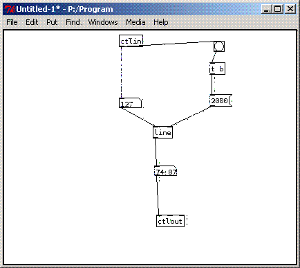

However, I made my first successull midi smoother in PureData! Probably not smooth enough but its working, can learn & assign the midi cc just fine :)
Its pretty cool! for a firs try :)
It looks pretty ugly! You can see the incomming CC already on 127 while the outgoing i still getting there!
