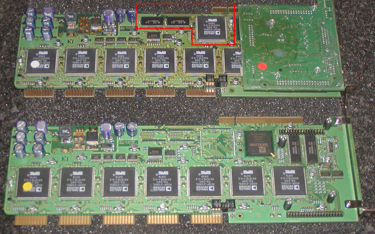

Ok i have these 2 scope cards and a pulsar2.
at the moment i am just using the pulsar, while i wait for new motherboard with enough PCI slots.
Scope 1. 15 DSP, onboard RAM 1ADAT, 1 Zlink, Midi, analog.
Scope 2 14 DSP no RAM no I/O
Pulsar 2 7 DSP, onboard ram 2 ADAT, MIDI, analog. 2 STDM

hey I always that all cards have just 14 dsp + 1 dsp for controlling the other.
so there really are two types ?
14 and 15dsp
+ memory and no memory....
thats interesting.

hifiboom wrote:hey I always that all cards have just 14 dsp + 1 dsp for controlling the other.
14 and 15dsp
thats interesting.
yeah the actual real "14" has an empty part on the circuit board where a sharc and 4 RAM chips are on the "15"
(i just noticed the scope 15 card has RAM chips on both sides, total of 4, the pulsar has 2)
so pulsar 2 has ram, 2 chips some scope have 4 chips and some have none and the ones who have none also have a SHARC taken off, which probably runs the RAM in the background.
