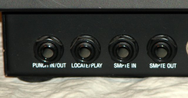

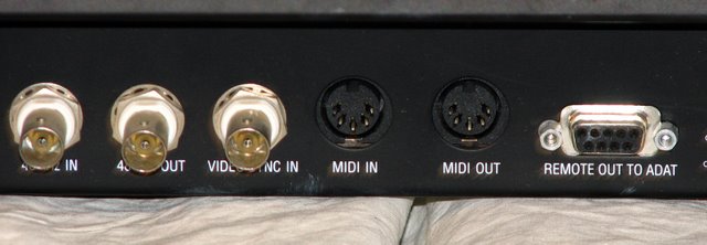

- IMG_1392.JPG (26.2 KiB) Viewed 5652 times
- IMG_1393.JPG (30.21 KiB) Viewed 5652 times
I've had the very same thought of using a BRC for convenience, but everyone who tried it seemed to have problems.
Afaik Immanuel from Danmark gave up on his - he got a very cheap BRC on eBay.
Possibly it's indeed related to the sample rate, as Janni points out with the pictures - the BNC is labelled 48k...
As I would have to buy a sync plate plus the controller it seemed a bit risky to me...
even more as my VDAT started to develope a 'personal' kind of madness, throwing the towel now and then in the mid of a recording etc.
Seems like it won't forgive any (not the slightest bit of) setup flaws regarding sync.
