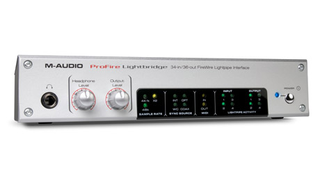

hi jimmy
look at this
http://www.m-audio.com/products/en_us/P ... -main.html
you don't need to install any pci card .... this mean that it can also work with a laptop !!!!
you can send/receive 32 ADAT via 1394 (firewire)
i have not tried it yet ... but will do it soon !!!
cheers
olive
look at this
cheers
olive
- profire
- profire.jpg (15.03 KiB) Viewed 3151 times

Hey Jimmy!
I'm using the m-audio profire at the moment with my macbook and
logic 8 & live 6 and I have to say it works great! (profire ist WC master)
But I'm sure RME does the job ways better and much more stable!
There's only one advantage of the profire: it's portable...
But since you will use a racked pc, I'd definately vote for RME since
it's absolutely rock solid with smallest latency and under full!!! channel usage!

hi
as far as i understand ... jimmy simply needs to route few audio outputs from a 64 bits VISTA DAW to his scope system ...
i didn't tried the m-audio yet but i will try the one of one of my friend soon, next week i think if i got time , but he regularly records 24 / 32 track with it ... using 2 A16 as converter ... synched via BNC WC ...
so , for this cheap price ... it could be a good alternative ...
@ astro ... about fire wire (1394)...
do you know Motu ? Mark of the unicorn ?
it doesn't seem that they dislike Fire wire 1394 ... see here ...
http://www.motu.com/products/motuaudio/
and definitely, instead of RME, and if my budget was ok, i would go MOTU ...
any way, i will try to post a review (just my impressions ...) when i test this box ...
@ jimmy : how to use it :
[ DAW 1 (64bits / Vista) ] < ------- firewire (32 busses)------> [ M-audio Profire ] < ------ ADAT (8 to 32 busses) -------- >[ DAW 2 (Scope - 1 or two boards with {24 ADAT I/O Plate} or {2X Classic or Plus I/O Plate} ]
cheers
olive

well, i DON'T like firewire for mission critical jobs, it IS unreliable, especially compared to pci or pci-e, but the m-audio's configuration looks perfect for Jimmy's use....
it depends. if the money isn't an issue, the answer is RME hands-down, i would think. for convienience and price, i'd say the m-audio looks great.
well, when firewire works, it generally works. when it doesn't work, you need a reboot. once every hundred times or so, and usually not during actual use, a computer can(not will) lose track of the firewire port and the stuff on it. pci never does that, so that's why i said what i said.
all i said otherwise, was that the m-audio looked like what Jimmy needed, as far as connections go and that i was sure it worked. firewire issues are another thing.
Jimmy'll have to make the decision, but it's good that he can see his options more clearly.
i think it's all pretty extreme, but Jimmy's hardcore, so i'm wit' it.

I actually use firewire frequently, and the laptop gets the budget m-audio firewire soundcard treatment (and Serato scratch). Usually the only time there is an issue is with a cable unplugging or when returning from StandBy I forget to turn a device on that was on before the laptop went into standby (thereby confusing the drivers). The m-audio drivers actually deal with this rather well only rarely becoming unstable. However their latency and cpu usage leave something to be desired imo...
The main cause of my recommendation of RME over M-Audio is the rock solid performance of the RME drivers with extremely low latencies and far more flexible routing. Also I prefer Scope clocked off my RME rather than vice versa, but that's very subjective so...
