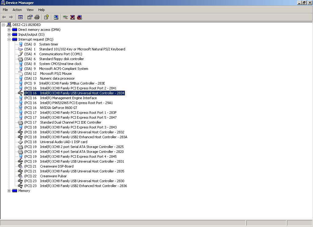

I think things are basically pretty good right now, however my only question is about the different "usb universal host controllers" which seem to be sharing every IRQ I have a card on.
Is that a bad thing? I havent fully tested this thing out yet, but preliminary investigation is not showing any signs of conflicts when I boot up cubase and my scope card at the same time. Anything I should watch out for? Any suggestions that can make this setup better?
irq jpeg.JPG (111.98 KiB) Viewed 1640 times
you need to disable the usb controller that is sharing with the scope card. you can do it right in the device manager.

Should I disable the usb host controller that shares the same IRQ as the UAD-1 as well?
I'm actually kind of confused when it comes to those usb controllers. Do each one of those correspond to a usb port on the back of the mobo.?If so, how do I determine which one is for which physical port.

yeah, i'd disable that one too.
the controllers work with most or all of the ports. one or two controllers are all that are needed for most or all of the ports to work. each controller can handle several devices. most modern motherboards have many more controllers than are really necessary.
