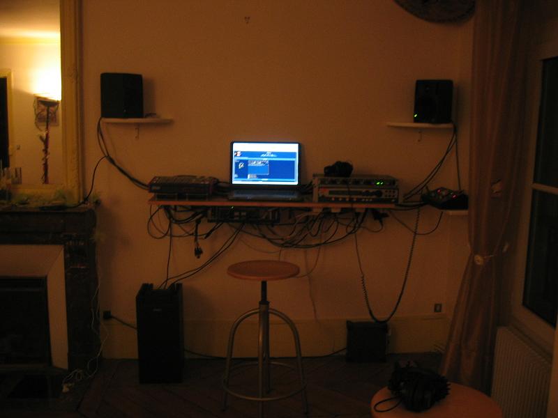

are you shitting me?? hey I worked hard to get it to look like that... not to mention my wife's opinion :lol: :lol:
the ultimate studio :-D
you could resize the picture tho ;-)
and delete the last one :-D :lol:
you did already :-D
