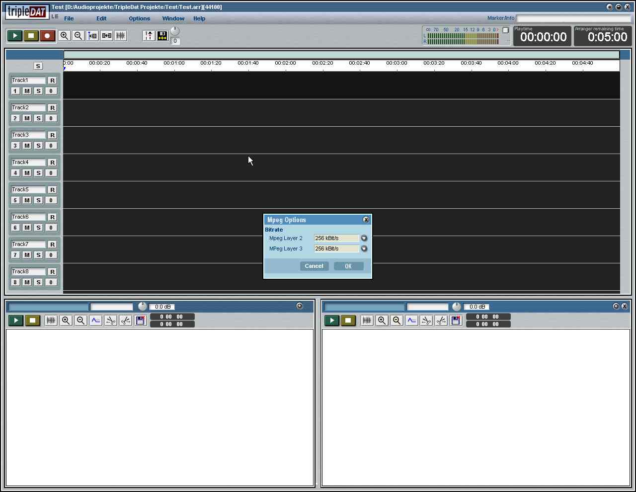

If you look in the Installfiles of TripleLE you find some mpeg 2setupfiles, but you can't use this important Audiocodec. If you change the original file mpegsetup.mdl (32kb in App/ TripleDat) with the file mpegsetup.mdl (16kb) from Cutmaster - you have mpeg 2 and mpeg 3 in the normaly Programm setup. You can downlaod the The Cutmastersoftware with the correct file from the creamware FTP Server.

I'm working with TripleLE mostly for a Radiostation. The Stationsfiles are alle in mp2, but TripleLe can just merge in Wave or mp3. Now I found a good solution
- Mpegsetup.jpg (68.37 KiB) Viewed 2904 times
