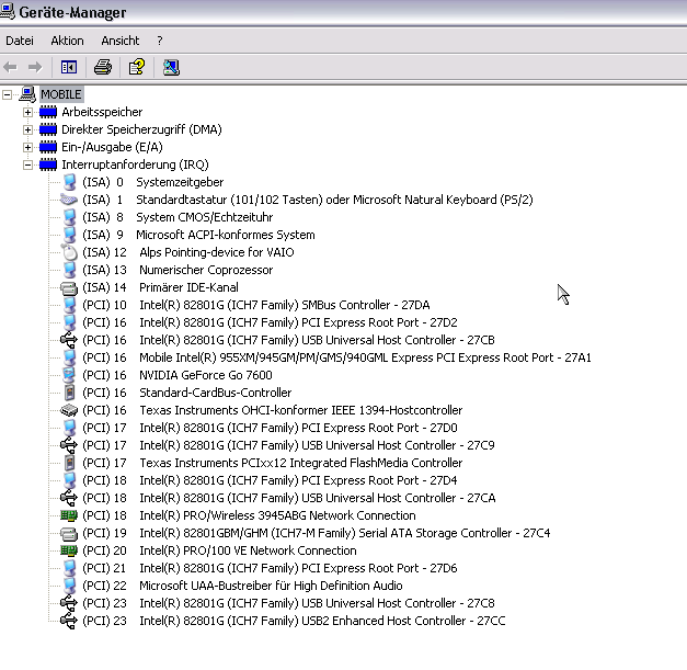

the only thing that is strange to me are the interrupts. most of the interrupts are sharing although there are enough that are free, so my question is how can assign the shared components to their own interrupt?
In the attachment you can see a picture of the interrupts in my sony laptop.
perhaps since acpi it is not so important like it was years ago with 15 standard interrupts, but can I change the interrupts or can I assign irqs to different hardware components?
thx
btw I´m using a Sony Vaio Fe31M and Desktop with an Asus P4PE Mainboard which has an Intel 845 chipset.
thx

Hi Helldriver! It's great to know you got it working, and especially good to know about the good performance of the PCI interface! So, you're running a Scope card and a UAD?Excellent. Did you make a new installation for Scope? Anyway, good job!
As for the IRQ sharing, it seems to be the normal XP way of installing hardware, and I don't think it's possible to change that, unless there's any option in the BIOS to force certain devices to certain addresses. in the laptop, I had Scope sharing the IRQ with the graphics card and the Cardbus controller, but it still worked well... If any device gives trouble, I usually just deactivate it on the control panel. Otherwise, uninstalling the device, then rebooting, forces a reinstall of the driver that, sometimes, also changes the IRQ settings. But it's a long shot...
Always best not to change anything if you're getting a stable performance!

And as for the device manager screenshot, i did that on my laptop when the magma pci extension was disconnected. I´ll make a second one when the magma is connected to the laptop again.

in my experience ACPI showed to be a bad thing for a pc with Pulsar cards onboard... (random noises and cracklings in recordings, for example) with Hyperthreading bringing to worse often (PC freezing).
This 'cause ACPI doesn't allow you control IRQ's assigning, and use them dinamically, changingthem (when it wants) for peripherals needs: just a hell for Pulsar card.
Converting ACPI to PC Standard makes all stable: find the right PC slot and you can even share Pulsar IRQ with the onboard LAN (maybe just not chat with MSN messenger while playing/composing with Cubase and similar softwares, sometimes blocks PC).
You can convert from ACPI to Standard PC in the same OS section you posted the image.
I had ASus P4PE when I first used Pulsar card: good and stable mainboard.
However I remember Creamware wrote about advice to not use Hyperthreading with Pulsar (incompatibility problems) and installing Win XP in standard PC mode and NOT ACPI.
This my experience.
Hope to be useful.
This my experience.
Hope to be useful.
All the best
Polarity, I think that Standard PC is not possible with multple core CPUs. Disabling HT was an option, but those were still single core CPUs (HT = "virtually" 2 cores).
There has already been some discusion on this subject here on Z, so it might be worth checking that out before you're faced with a unrecoverable installation.
