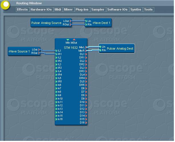

open the routing window hit print screen open your favourite image editor and paste it in ,save the image as jpeg and let us have a look It probably some sort of audio loop which is feeding back on itself.I'll give that a 3:1 chance.Any takers.

Hi folks, well heres a jpeg of the routing window...and yes, the problem still occurs even witht this ultra simple set up.
Tried swapping pci slots yesterday :(.... still no change. Will try in different pc today.
wave dest.JPG (40.14 KiB) Viewed 6219 times

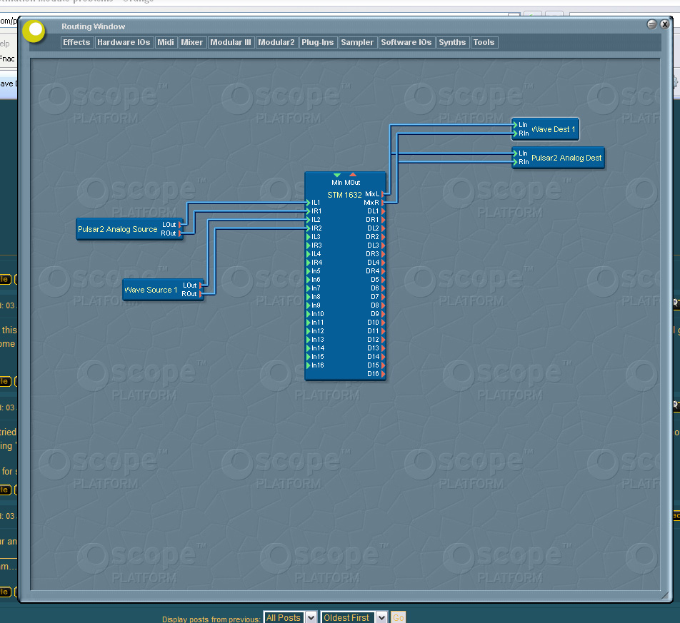

Put your analog source into the mixing desk and the wave dest in parallel with the pulsar analog dest.
Scope try this
Scope try this

I tried that too. Its been reduced to the minimum to try and identify where the fault is. Usually it would be connected pretty much as you suggest.
