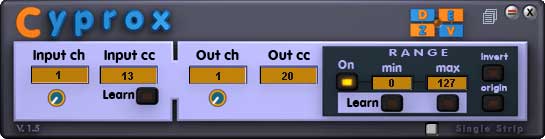

Hello,
this is the single strip version of the Cyprox cc converter.
I have worked on the circuit to make it simpler as possible and to prevent bugs.
The min/max range control has been optimized and i have added the learn capability to select the range straight from your hardware controller.
The way cyprox process midi control numbers is different from the typical scope devices, so forgot about right click assignment of midi cc and forgot about saving midi controller list from the preset list, because all you need to do is to enter or learn the cc numbers and you are done and of course it's enough to save the simple preset list to recall all parameters of cyprox.
The surface has been redesigned by Mehdi Touzani from Spacef .
I'm working on the documentation, but it's very simple to understand how to use it.
All my next devices will be available from devz.org web site.
A short explanation of the cyprox controls:
input ch: select the midi input channel to be recognized
input cc: select the input cc number to be recognized
the learn button can be used to automatically recognize the incoming cc from your hardware controller
another use of the learn button is to have the option to process every incoming cc when the button is switched on.
Out ch: the output midi channel
Out cc: the control change to be sent to the cyprox midi out (values from 0 to 255 possible)
on button: to disable the cyprox cc engine
min and max range: you are free to enter a value between 0 and 127 to obtain the action range of your choice.
range learn: if enabled you will be allowed to enter the range from your hardware controller.
this button can be used as a range bypass when it's switched on.
Invert: to invert the direction of the cc (min will become max and max will become min)
origin: to send the original cc message to the midi output of the cyprox (not processed, so no min-max range or invert available to the original cc message)
