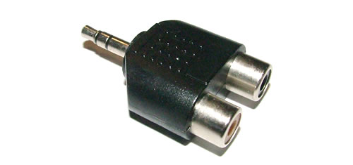

Post by ali »
Or this
mini jack adapter.jpg (2.89 KiB) Viewed 5307 times

the cable with the ministereo-2RCA may (seem to) work, in particular if it's very short. But it can in no way be guaranteed - S/pdif requires a 75 Ohm certified cable, and afaik no such thing exists with the connectors shown above.
the usual approach would be to use the adapter from picture 1 plus 2 certified cables for digital audio.
The (cheaper, often yellow jacked) 2xRCA video cables for 'multimedia' also seem to work (at least they ARE 75 Ohm).
