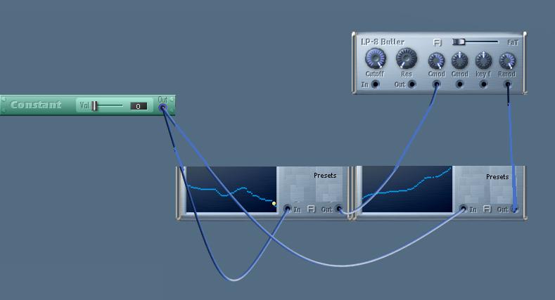

(1) a constant value module would be able to control the cutoff and resonance of a filter simultaniously in an very spectacular way....
So we could model the unlinear behaviour of resonance and cutoff
(look on the demo picture)

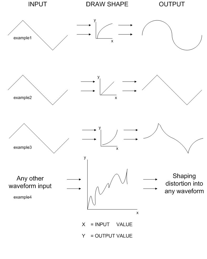

I think my first explanation was a bit misleading....
so I did draw it with Visio what I wanted to explain. :lol:
here is what I mean... The example only shows some tasks with a Triangle as input.... but surely it would alter any other oscillator waveform in the desired way.....
but it should also work with audio input and other modulating sources like LFOs and other stuff....
this would be the most powerful shaper.
you could shape a triangle into a sinus and everything in between
or a sinus into something closer to a square.
with less simple drawings like in example4 you could freshen any audiosource, roughen 303, make kicks harder and so on....
...or plug it behind an osc for new creations and other nice stuff....
switched behind a constant value module it could give us unlinear curves for controlling cutoff and resonance of a filter in a unconventional way and more natural way....
a preset button could hold the different shapes for instant checkout.....
@astro: convolution would be applying an impulse on any input freq. so it would be time-depended operaton.
this shaper just takes an audio amplitude value of a dedicaded input bit depth (16,24,32 - don`t know which bit depth modIII is working with) on timepoint A and outputs a new value for timepoint A.
In german scientific calling would be a "mathematische Abbildung".
a transformation / mapping process
in a programming language I would do it with an array that holds for every input value 1..32768 (f.e. unipolar 16 Bit, 1bit for polarity) a new output value, while the values are calculated by the drawn curve...
But I`m sure its not that easy to do with CW SDK. As I don`t have access to an SDK I cannot give any further recommendations on how to do it.
:roll:

hifiboom wrote:I would do it with an array that holds for every input value 1..32768 (f.e. unipolar 16 Bit, 1bit for polarity) a new output value
that is exactly what Wavedraw does, check it.
if you patch it like this
you'll use it as a fx (64 sample resolution) which re-maps (distorts) incoming values (audio).
btw, I've made it in *old* Mod2 shell, because the waveshapes are not stored in mod2(new) and ModIII presets)
BUT exact mapping isn't possible with wavedraw.
So something like building a new key scale (eg for Karplus strong) is not available.

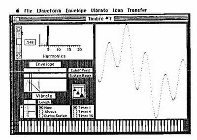

Posts: 8466
dunno if you've noticed it (as a fun contribution) in S4L's CPU force thread, but I'm pleased to post it again - it's a 20 years old screenshot from a MacPlus ;)
note the similiarity to the external forum picture you refer to
this one shows the resulting waveform from an additive synthesis with the partials distributed as in the upper left diagram (it's ConcertWare's instrument builder)
the external picture shows a waveform that's modified by splines
obviously this method yields quite similiar results, as there's also a list of instrument timbres visible
these waveforms 'sound' good because the graphic function is controlled by parameters that have an 'acoustically relevant' scaling, opposed to random mouse drawing.
